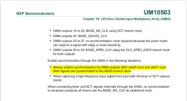

I'm trying to trigger an ADC channel with a Timer, but it isn't working. Could you tell me where is the mistake? I'm using an LPC4337.
This is the code :

Just in case anyone else runs into this, the EDGE bit (0x2) also needs to be set in order to the trigger the ADC.
LPC_GIMA->ADCSTART0_IN = 0x6;

I found the solution reading the chapter about GIMA:
So, what worked for me was to add the following line:
LPC_GIMA->ADCSTART0_IN = 0x4;‍‍
