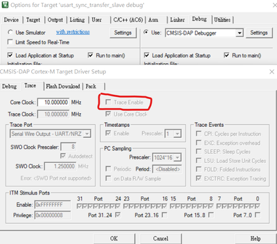

I recently acquired a LPC51u68(OM40005) board.  I tried to use printf for debugging in Keil (v.5.38.0.0).  But I found I cannot enable Tracing.  As shown in the screenshot below, the check box of Trace Enable is disabled.  How can I get to enable it?
Thanks.

Hello @yulung
The required trace interface needs to be supported by both the microcontroller and the debug adapter.
Trace Enable is disabled because your adapter doesn't support this function.

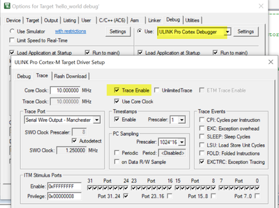

For example I choose ULINKpro , it can enable:
