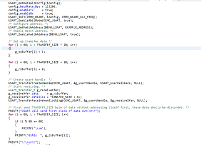

Previously, LPC800 used peri_driver, which can be applied to 9bit usart.
But now the driver created by sdk builder can't be applied.
It's too complicated and resource-intensive for small MCUs.
The sdk should keep lower-level drivers, like the STM's LL driver.

Alex_Tsai
I'm not sure which version of the SDK you are using.
There is USART_Enable9bitMode() in your posting, but not in the SDK v2.16.
I also cann't see the USART_TransferSendNonBlocking() function in your posting.
USART_TransferSendNonBlocking() function it will start interrupt, but the ISR have bug, the type will be limited to 8bit.
Refer to fsl_usart.c line.896.
2,946 Views
Harry_Zhang
Hi @Alex_Tsai
Sorry, the code is lpc55s16 Usart 9bit interrupt transfer demo.
The lpc824 doesn't support the 9bit usart demo.
So I suggest you can refer to lpc55s16 Usart 9bit interrupt transfer demo and modify the lpc824 usart demo.
