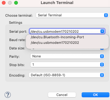

Using my Mac, i've managed to get a terminal window on MCUXpressoIDE (Shift+CTRL+ALT+ T) but when I select the serial port drop down I do not see the LPC845-BRK's port available (the lpc845 is switched on and plugged in). See pic below ..
As a result I cannot see any output to any code I use (Hello World, for example).
Many thanks, again
** AMENDMENT ** - The LPC845-BRK serial port appears as the 2nd option (the usbmodem) from the picture above.

Do you use MCUXpresso IDE, if yes, you can use "Terminal View" of  IDE.
Detail please refer to MCUXpresso IDE User Guide-> 19.8 Using Terminal View for UART communication with target.

Perfect!,
Thanks Alice. I wonder why the instructions mention terra term / putty then ?
Anyway, I will use the terminal window and go from there.
