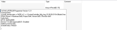

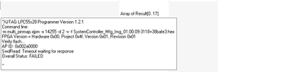

Hello community,
I have the following issue when I trying to lock the MCU LPC55sXX. Unit ng.png
I am following these steps to lock the MCU:
1.- Configure the MCU in ISP mode.
2.- Write the bin file to the CFPA.
3.- Write the bin file to the CMPA.
4.- Verify if the MCU is locked and expected the following result: Unit good.png
The issue occurs intermittently.
Any help would be greatly appreciated.
