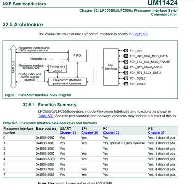

In the header file of LPC55S06.h I seen below thing
#define SPI_IRQS { FLEXCOMM0_IRQn, FLEXCOMM1_IRQn, FLEXCOMM3_IRQn, FLEXCOMM4_IRQn, FLEXCOMM6_IRQn, FLEXCOMM7_IRQn, FLEXCOMM8_IRQn }
Here I am not able to see support for SPI in Flexcomm 5 but in data sheet it is mentioned that we can use flexcomm5 as SPI, when I tried to use flexcomm5 as a SPI in MCUXpresso it is also saying we can't use this as a SPI so why data sheet is telling that and if it is true what is the way to use flexcomm5 as SPI in LPC55S06?

For the LPC55S06, as you know that the SPI requires 4 signals, the uart requires only 2 signals. Because of pin limited, the FC2 and FC5 does not support SPI, but they also support uart, I2C and I2S functions.
It is wrong to define:
Because the FC2 and FC5 can not be configured as spi for LPC55S06
Hope it can help you
