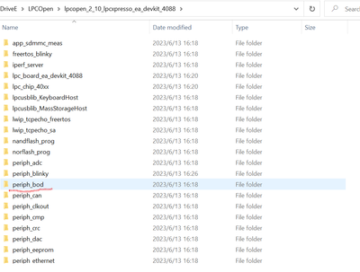

rubensjunior
Dear @xiangjun_rong,
Please can you help me to find code examples with BOD implementation for LPC1857?
Rubens Júnior
2,584 Views
xiangjun_rong
Unfortunately, I do not get the BOD example for the LPC1857, but there is BOD example in the LPCOpen package for the LPC4088, pls refer to it.
Hope it can help you
