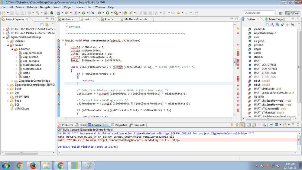

Thank You for your reply.
i have send you screenshot of example code, error, and console window.
 what i have done.
1)import code as per pdf explanation on JN-UG-3098 on page number 26.
2) as i open code it's show so many error. (please check image)
3)As is showing error still i compile code and you can check console box.
4)i have try few more example like JN-AN-1162/1123/1172/1171 but result is same.
5) i reinstall beyond studio(4165) and tool chain(4141)
JenNet-IP|NXP  from this website..
6) In problem window its shows so many error.
some header files are missing its not present in included file or C drive.
Please help.

Hi Dheeraj,
What is the app note that you are trying to compile? The screen that you attached.
Can you compile this application note JN-AN-1162?
Note: The errors you are seeing is Eclipse not being able to resolve various variable and functions within the SDK. But you can compile without problems.
Mario

mario_castaneda
Hi Dheeraj,
I'm sorry for this.
But, could you please check the console, and you will see all the process without the errors.
Please let me know if you still have this problems.
Mario
