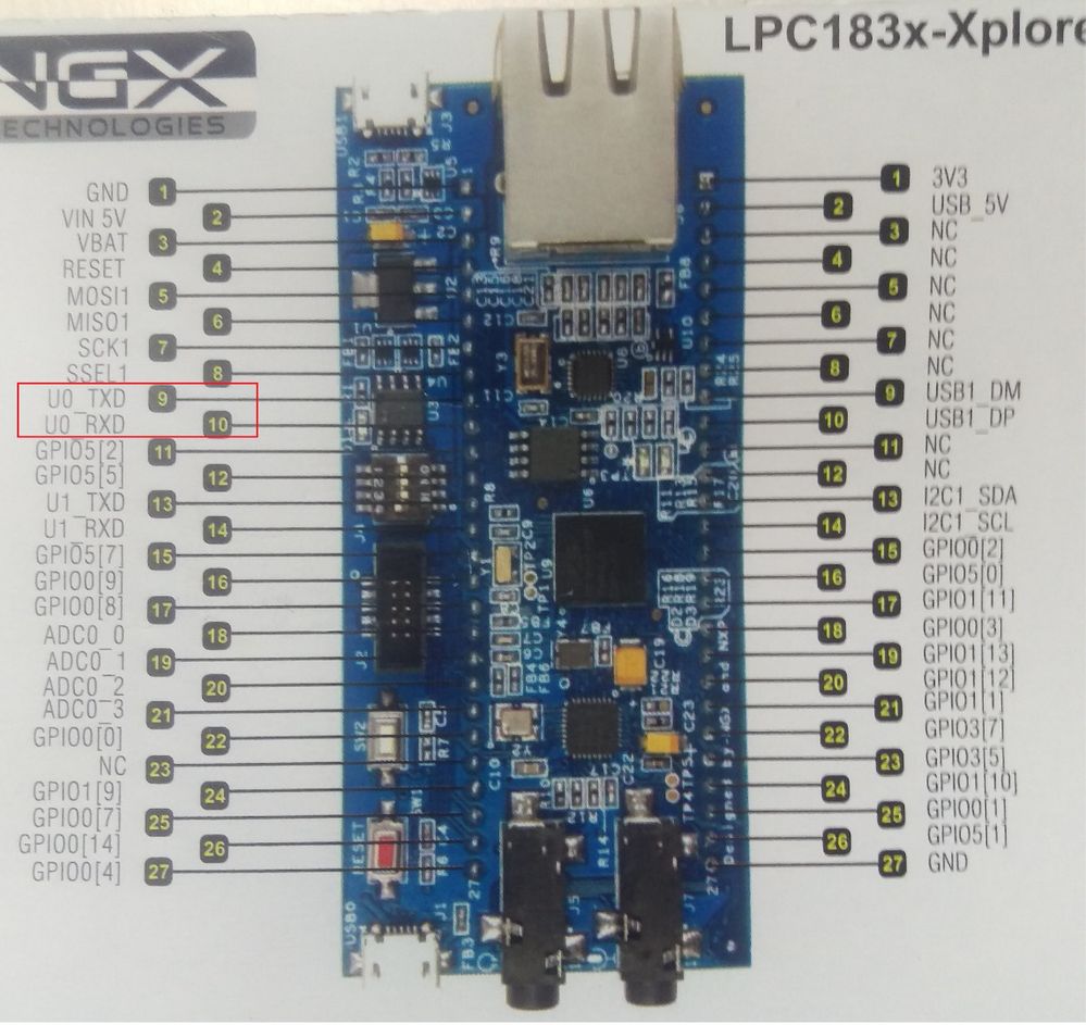

I am working to interface uSD card using SSP1 controller of LPC1837 (In built SD controller is fixed for some other functionality).

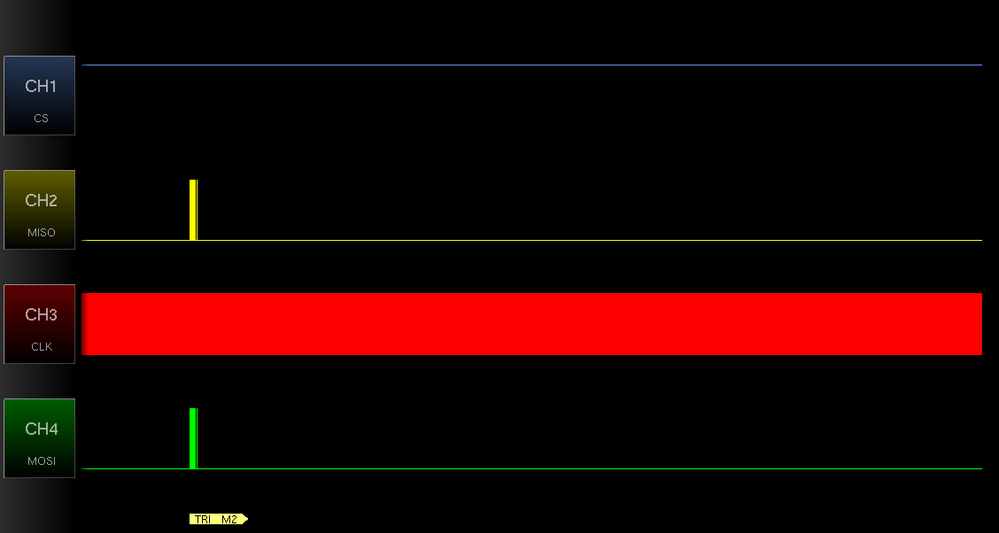

SSP1 controller is configured in master SPI mode with CPOL & CPOH as 0. I have seen the clock is coming continuously just after initialising the SSP1 module without even starting the actual transfer of the data. This is not expected behaviour, please give your inputs If I am missing anything during configuration.

  • IKALogic analyzer capture CLK, MISO, MOIS @1Mz (also used 5 & 10MHz sampling), Signals probed are shown below
  • Working on LPC183x-Xplorer board.
I have shorted MISO line to MOSI line that is pin 5, 6 of J8 are shorted.

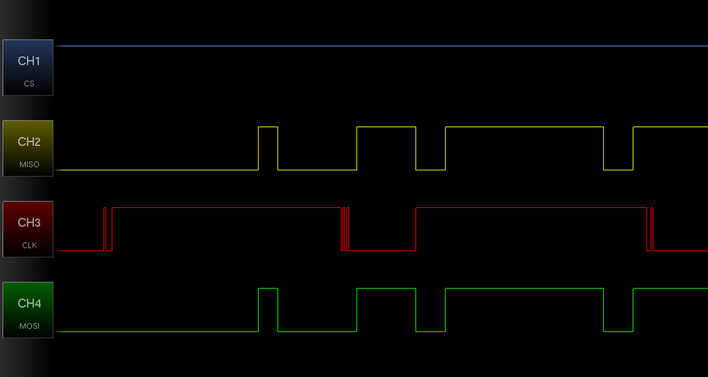

I have probed signal on logic change of the clock line, I see peculiar behavior of clock, Please give your comments
CLK is red line
Following is the serial console output, it shows transfer is passed as the MOSI & MISO are proper, but clock is not as expected/
Please give your comments why I am seeing the clock with 50% duty cycle?
I see clock is coming even though there is no data transmission. In the below scenario I have transmitted 6bytes, but the clock is keep on ticking??
