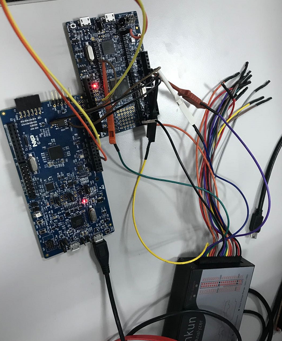

1. Hardware
  SPI master: LPC4367 or LPC43S67, use the lpcxpress board.
  SPI slave  : LPC11U68, use the LPCXpresso board'
1)LPC4367  SPI pin
SPI_CLK   :  P3_3
SPI_MISO :  P3_6
SPI_MOSI :  P3_7
SPI_SSEL :  P3_8, GPIO control
Note, if you use the lpcxpresso LPC4367 board, remove JS23, just disconnect it from the external flash.
2)LPC11U68
SPI_CLK    :  P1_29
SPI_MISO  :  P0_8
SPI_MOSI  :  P0_9
SPI_SSEL  :  P0_2,
Connections:

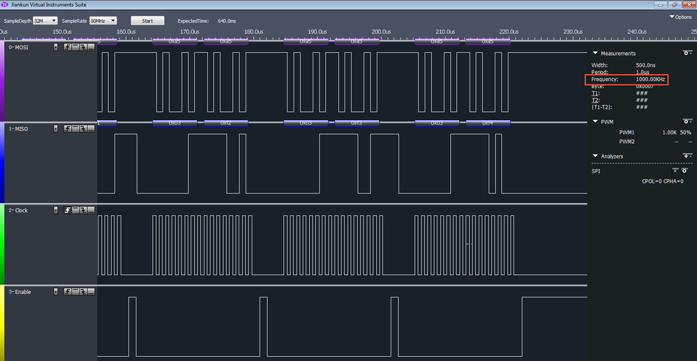

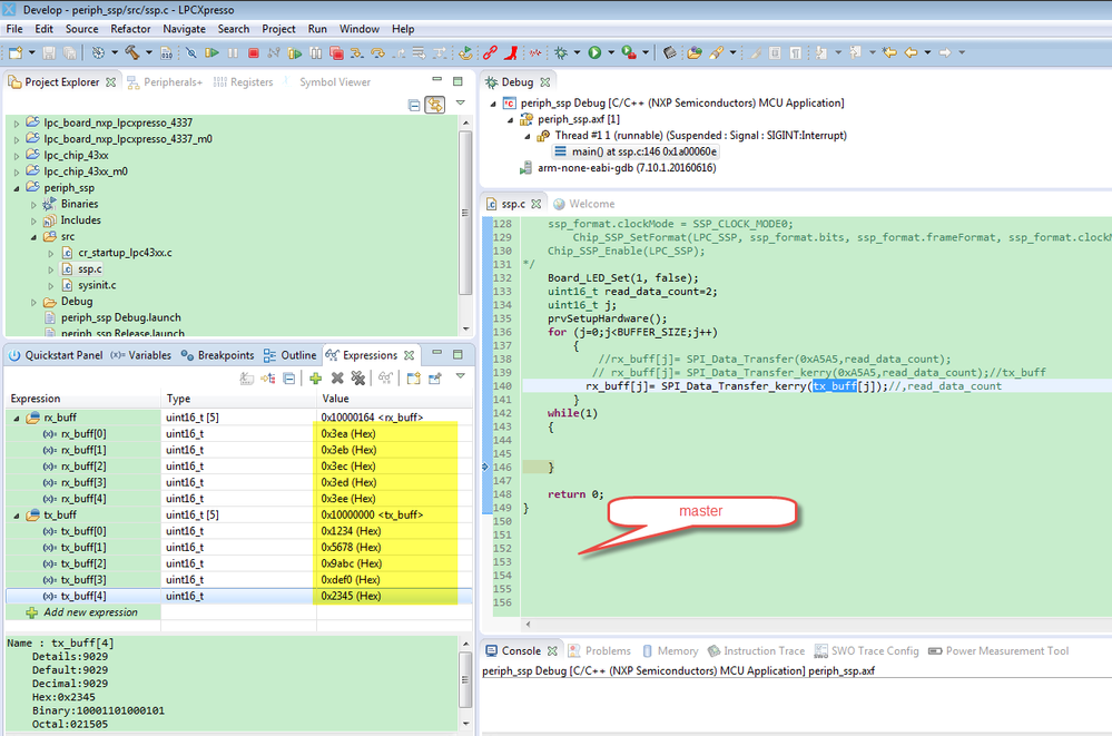

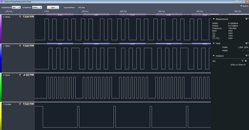

4. Test result

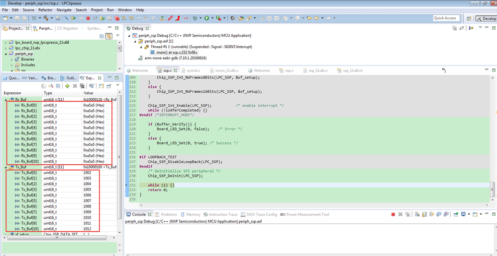

1)LPC11U68 debug code
You can find the LPC11U68 slave can receive all the 0XA5a5 from the master side.
2)LPC4367 debug code
3) SPI bus wave
From 2) and 3), you can find the master also can receive all the correct data from the LPC11U68, I didn't add the delay which you mentioned.
The SPI baudrate is 1Mhz.

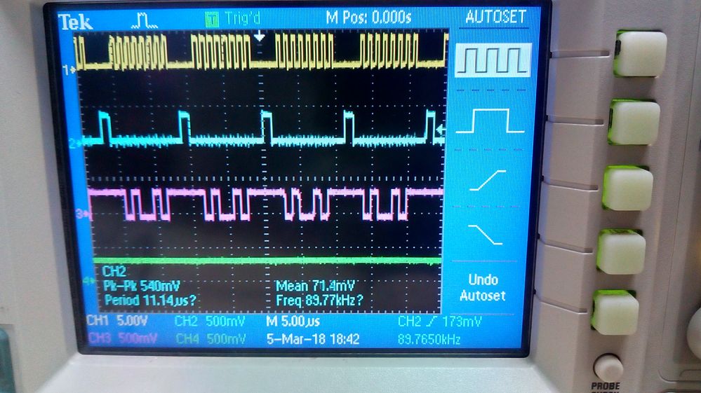

2. Test the SPI wave then send it to me.
  Please use the logic analyzer or the 4 channel oscilloscope to test the SPI bus wave: SPI_CS, SPI_CLK, SPI_MOSI, SPI_MISO.
  Check the wave, whether the SPI bus wave is correct to the slave? It's very important.
  After test, please send me the SPI wave with problems.

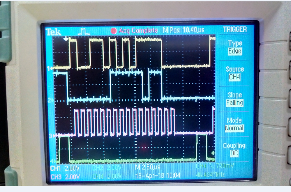

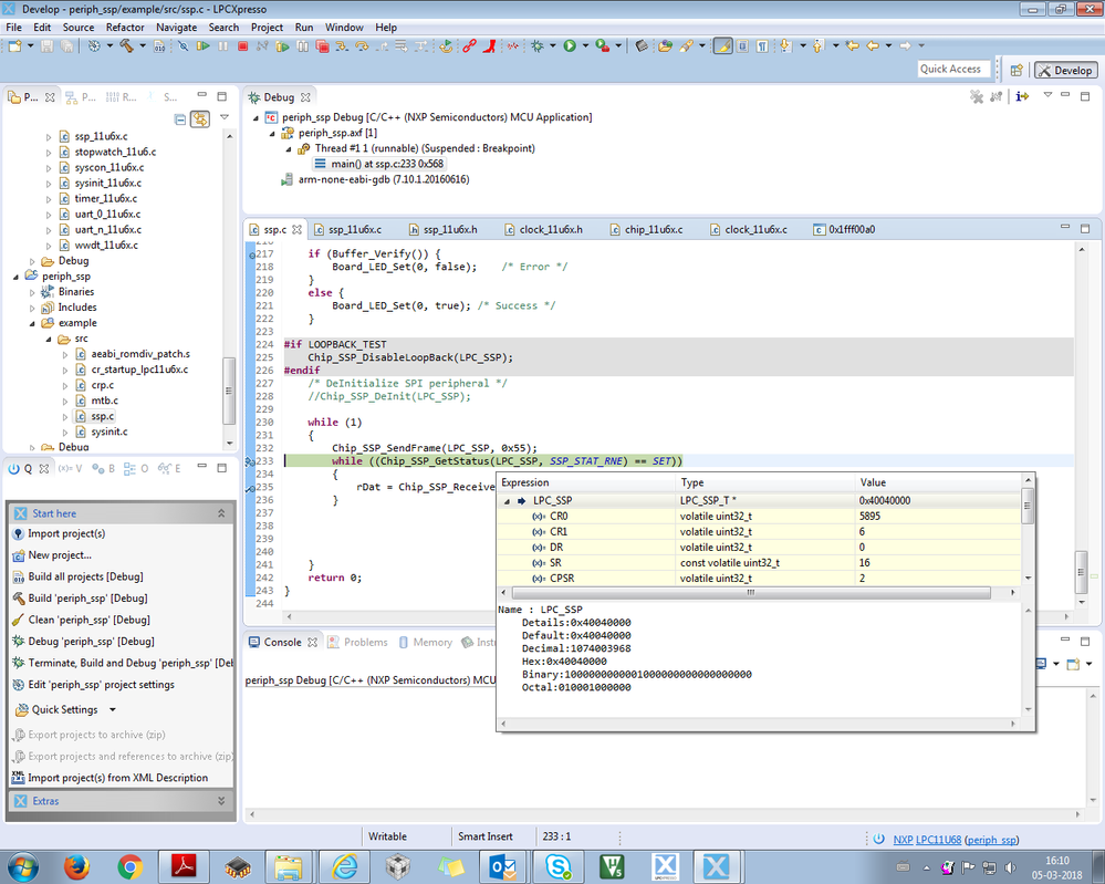

gauravmore

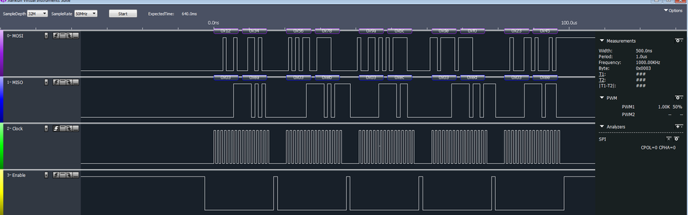

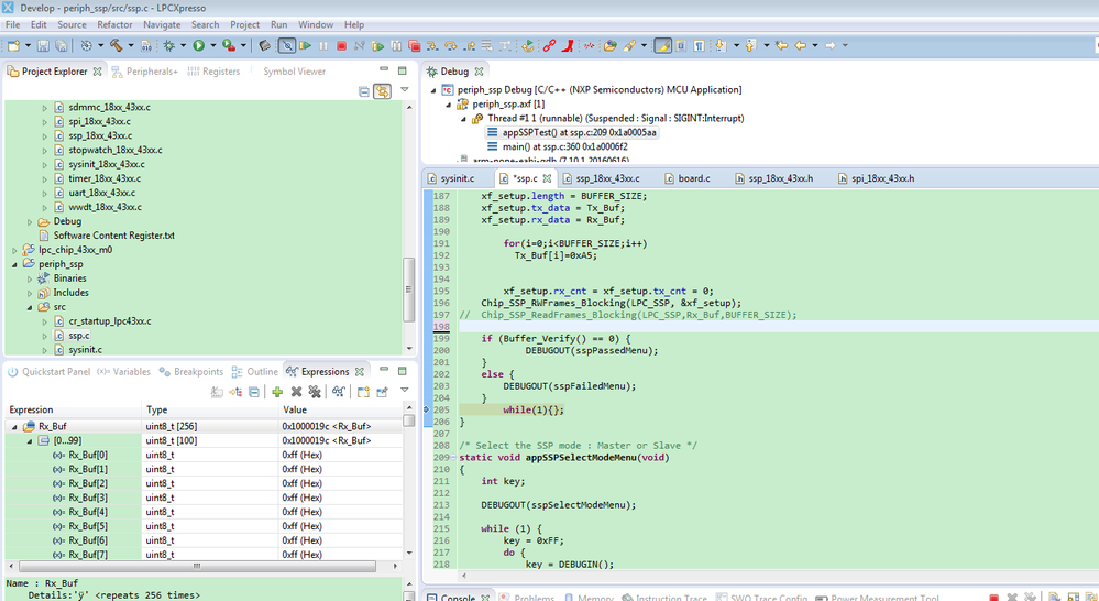

Hello Kerry,
Considering your inputs mentioned above i made changes in the code and made both master and Slave device to same  mode (Mode 0). Here the master device is LPC4367 and Slave is LPC11u68. Rest all the configuration are unchanged. But still i got  the same result.  I am not able to receive any data at the slave side.
Considering the 2nd input please find attached wave forms for your reference. Here the yellow line is for SCLK, Blue is for SSEL, pink one is  for DATA (MOSI) and Green is (MISO). The data transferred is 0XA5 from master to slave and slave is suppose to send  0x55 but you can see that there is not output from salve. SSPWave.jpg

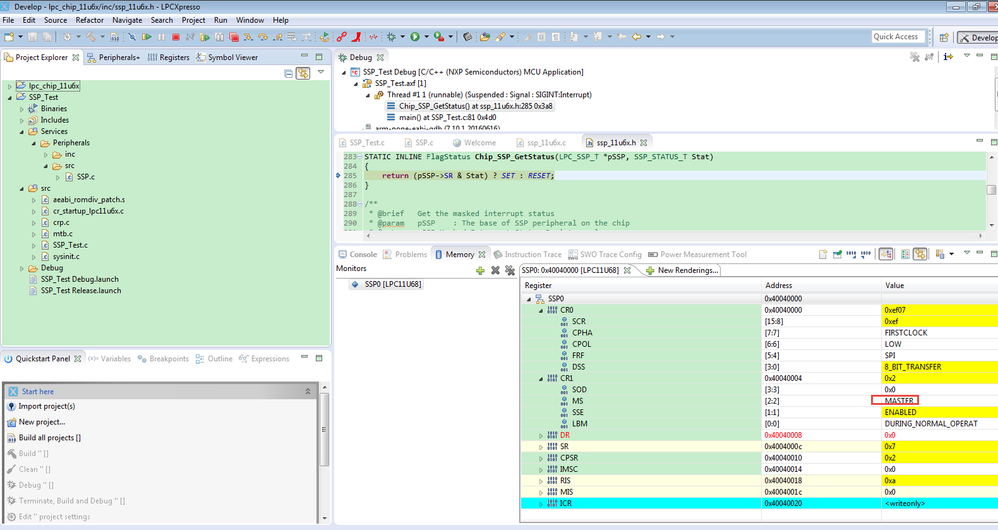

I have also attached the screens shot of the status of the slave register and you can see that SR value is 16. it remains in the same manner.
Regarding the Code please find the details of the code mentioned below

kerryzhou
Hi Gaurav More,

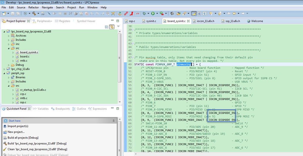

   I have tested your code on my side, and debug the register, now it works OK on my side.
   One point need to do the modification:
static void Init_SSP_PinMux(void)
#if (LOOPBACK_TEST == 0)
#if defined(BOARD_MANLEY_11U68)
#warning "No SSP setup defined"
#elif defined(BOARD_NXP_LPCXPRESSO_11U68)
//#warning "No SSP setup defined"
     Chip_IOCON_PinMuxSet(LPC_IOCON, 1, 29,(IOCON_FUNC1 | IOCON_MODE_INACT));
     Chip_IOCON_PinMuxSet(LPC_IOCON, 0, 8,(IOCON_FUNC1 | IOCON_MODE_INACT));
     Chip_IOCON_PinMuxSet(LPC_IOCON, 0, 9,(IOCON_FUNC1 | IOCON_MODE_INACT));
     Chip_IOCON_PinMuxSet(LPC_IOCON, 0, 2,(IOCON_FUNC1 | IOCON_MODE_INACT));
//     Chip_IOCON_PinMuxSet(LPC_IOCON, 0, 2,(IOCON_FUNC0 | IOCON_MODE_INACT));
//     Chip_GPIO_SetPinDIROutput(LPC_GPIO, 0, 2 );
     Chip_IOCON_PinMuxSet(LPC_IOCON, 1, 29,(IOCON_FUNC1 | IOCON_MODE_INACT| IOCON_DIGMODE_EN));
     Chip_IOCON_PinMuxSet(LPC_IOCON, 0, 8,(IOCON_FUNC1 | IOCON_MODE_INACT| IOCON_DIGMODE_EN));
     Chip_IOCON_PinMuxSet(LPC_IOCON, 0, 9,(IOCON_FUNC1 | IOCON_MODE_INACT| IOCON_DIGMODE_EN));
     Chip_IOCON_PinMuxSet(LPC_IOCON, 0, 2,(IOCON_FUNC1 | IOCON_MODE_INACT| IOCON_DIGMODE_EN));
#else
#error "No SSP setup defined"
#endif
#endif

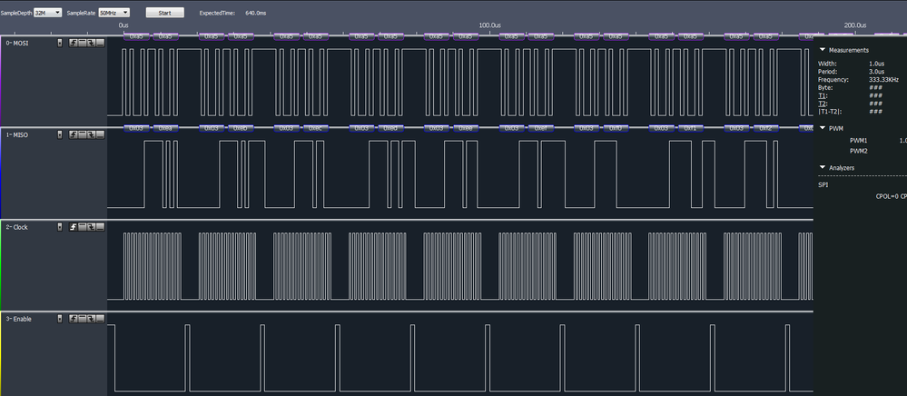

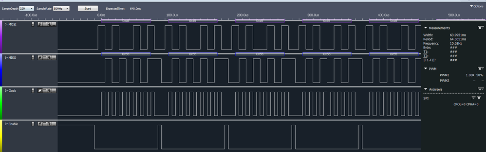

This is the test SPI bus wave:
You can find the MISO send out the 0X55 which is your needed data.
I also attached my modified project for your reference.

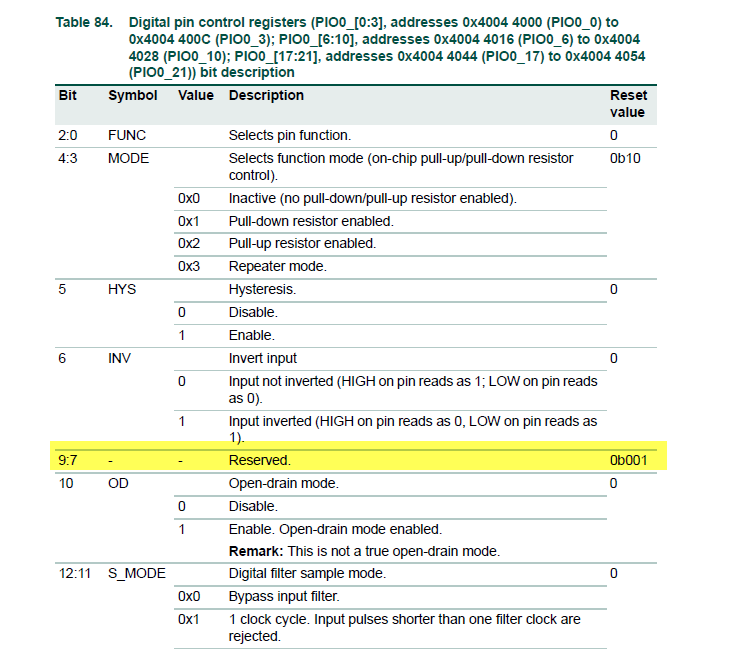

Your original configuration will make bit9:7 to 0, that's why your SPI slave can't work.
Wish it helps you!

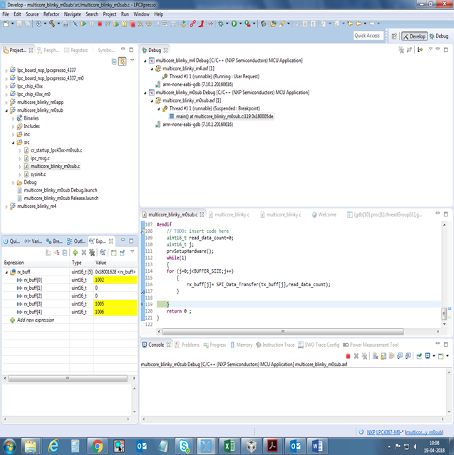

gauravmore

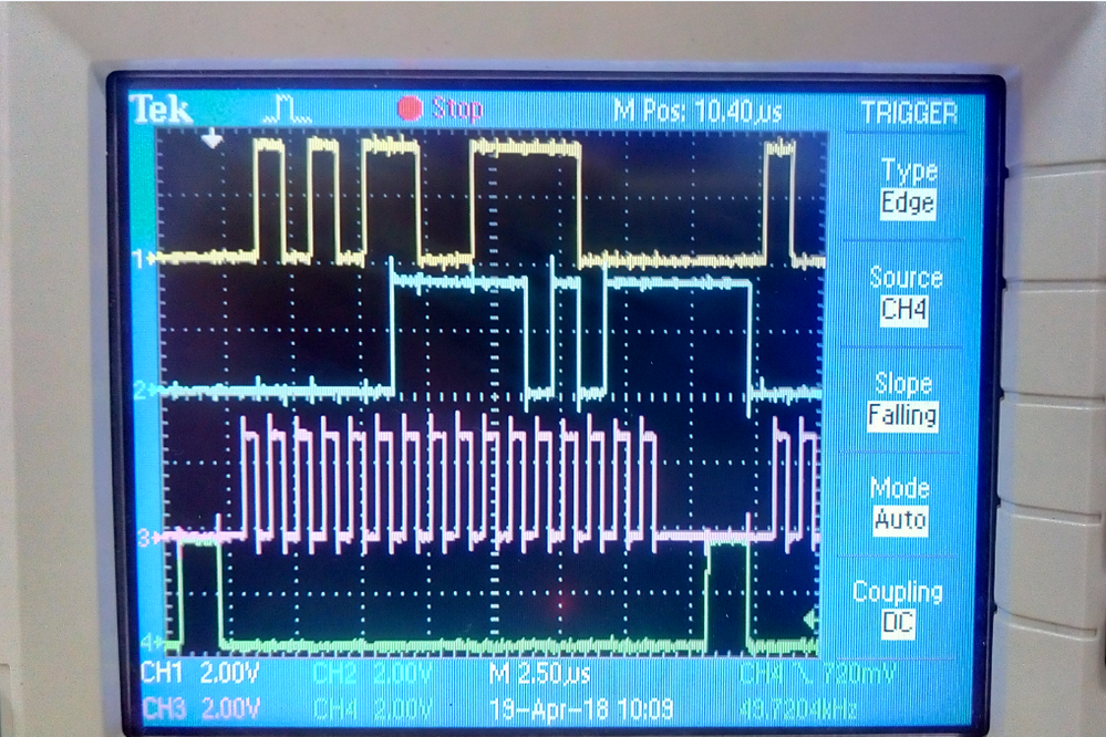

Hi Kerry,
I have checked the code also which i had sent you . There is a problem with that code so i have modified and checked from my side . Consider the attached code for your processing and reference. Modification in that code is done with respect to the sysinit function where the peripheral clock was not enable and in SSP Init where bit format is changed from 8 bit to 16 bit. I have tested the code from my side and I have taken the snap shot of the observation and the waveforms of SPI Communication.
Please find below the waveform of with Delay and the data received with Delay or Timeout.
Waveform Details Yellow = MOSI, Blue = MISO, Pink = Clock, Green = SSEL
You can see that the data received is  1002,1003, 1004,1005,1006 and also find attached Waveform with Delay and Data received Without Delay.
Here You can see the data is lost and 0 is received in between 1002,0,0 ,1005,1006.
Kindly go through the code and update the details accordingly.

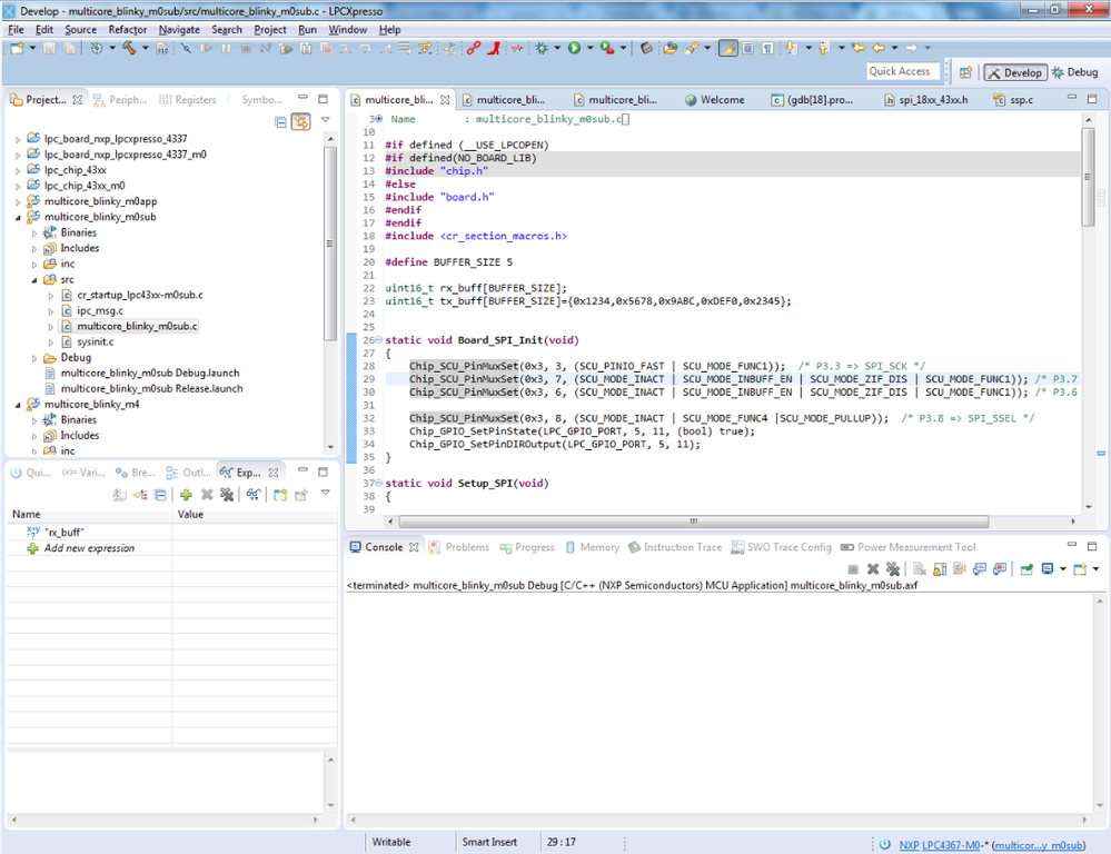

We have check with tyour code that you have sent but but it that we did modification in master side by adding sequence of data to be sent by master to slave as mentioned below in tx buffer ,
uint16_t tx_buff[BUFFER_SIZE]={0x1234,0x5678,0x9ABC,0xDEF0,0x2345};
AS a response we are recieving wrong sequence to slave even though we are recieving correct sequence in master. see the screen shot below,
You can see that the sequence is not matching. So i request you to check it with our code of SSP since i think it is not yet resolved and the data is still not matching. Even after adding clear status line.

Hi Gaurav More,

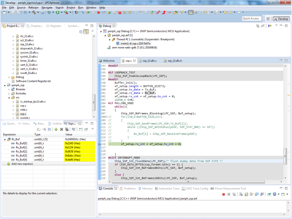

    I have tested your newest slave code, this code still have problems, this is the SPI bus wave:
  Your LPC11U68 slave MISO didn't send out the correct data.
  It seems you didn't test both my SPI master(LPC43S67) and slave code(LPC11U68), this is my test result with the modified master and slave:
1. SPI BUS wave
You can find both mosi and miso in the SPI bus wave is correct, which you need is:
LPC43S67 Master
  Send: 0X1234, 0X5678,0X9ABC, 0XDEF0, 0X2345
  Receive: 0X3ea, 0x3eb, 0x3ec,0x3ed,0x3ee
LPC11U68 Slave
   Send: 0X3ea, 0x3eb, 0x3ec,0x3ed,0x3ee
  Receive: 0X1234, 0X5678,0X9ABC, 0XDEF0, 0X2345
2. Master LPC43S67 debug result:
You can find both receive and transfer data is correct
3, Slave LPC11U68 debug result
You can find the slave both send and receive data is correct.

Hello Kerry,
Thanks a lot for for providing the solution. I cannot find the difference since the details regarding the configuration is not mentioned in the data sheet as you can see that those bits are reserved and so did not made any modifications. Request you to please provide this information in the user manual. It will help us in configuring the same.
The latest datasheet which I referred is of Rev 1.8,  19 December 2016.
Since these bits are reserved it is possible that user may not change that bit and attempt to change it. I have check the code that you have sent and compiled it . It is working fine. Further more testing will be continued and will reply you if in case any issue is there . But thank you very much, :-)
8,381件の閲覧回数
kerryzhou
Hi Gaurav More,
    That's very good to hear you also make it works with this workaround.
    Yes, the user manual really didn't add the note about this point, but normally, if the register reserved area have the default data, please keep that default data, don't modify it.
Actually, in the lpcopen code, you also can find the official code also configure that area to the default data:
   So, next time, if it not work, you also can check the official code configuration.

Hello Kerry,
I have implemented and established SSP communication between LPC11U68 and LPC4367. But i am facing the issue while reading the data sent from LPC11u68 controller. Follwing are the details of the configuration of both the controller for communication.
LPC11U68:
Controller freq: 48Mhz, SSP Clock Rate: 1Mhz, Slave Mode , Mode 0
LPC4367:
Controller freq: 100Mhz, SPI Clock Rate: 1Mhz, Master Mode,  Mode , Mode 0, SPI peripheral freq: 50Mhz
Now master controller is asking data to slave and slave is responding the data available. But  here slave controller is recieving the data sent from master but master is not recieing the the data sent from slave to master in free running mode.
but when put delay while reading the data from slave then i recieve complete data expected. below is the code of reading at master side
                     Enable_CT_SS();
                     Chip_SPI_SendFrame(LPC_SPI,Tx_data);
                     while(!(Chip_SPI_GetStatus(LPC_SPI) & SPI_SR_SPIF)||(ul16_Timeout_count++ < timeout));
                     ul16_RxData = Chip_SPI_ReceiveFrame(LPC_SPI);
                     Disable_CT_SS();
 Here it checks for  SPI transmit flag and the timeout delay before reading the data.  But if i remove the part from the master side then it recieves 0 and the data get sifted.
Please let me know the reason for the same since both controllers are running with different frequency . Also in SSP there is a provison of checking RX flag and TX flag but in SPI there is only one flag TX flag. When Slave transmit data it is in busy state but at the master side since the transmit flag is ok it reads the data and close the CS.
Kindly let me know the solution or the reason for the same.

gauravmore
Hi Kerry,
Please find  attached code for  SSP and SPI  for your reference. I am using LPC11U68 and LPC4367 and using evaluation board for OM13058 for LPC11U68  and OM13088 for LPC4367. Editor is LPCEpresso V8.2.2_650. Kindly go through the code and let me know any further changes are required

kerryzhou
Hi Gaurav More,
    In your last email, you said:
LPC11U68:
LPC4367:
LPC11U68 is the slave, but why in your code, you configure it as master? Please check your attached LPC11U68 code:
Please check it again, did you meet the problem that when configure the LPC11U68 as master, and LPC4357 also the SPI master?
Please give me the clear goal, who is master, who is slave? Your problem is on the LPC11U68 or the LPC4357? If you have the problem SPI bus wave, please also set it to me.
