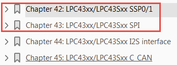

In the LPC43xx, the SSP0/1 and SPI module both are able to interface external SPI device.
You can learn the more information in these chapters.
