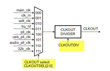

Hi all,
I have an Eval Board OM13092, and I would like to know how can I have access to CLKOUT function (on which pin of the board, and what code is needed to configure the uP to output the main clock) ?

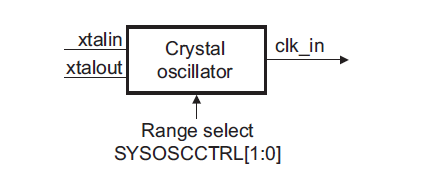

I would also like to know how to configure my board to use an external clock ( the code needed to configure CLKIN and and on which pin should I actually put my external clock) ?

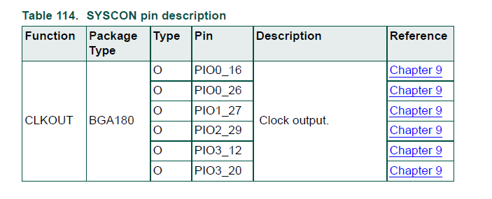

   1. CLKOUT pin
   If you want to use the CLKOUT pin, you can enable the according pin as the CLKOUT function.
  From the user manual, you can get that:
If I select PIO0_26 as the CLKOUT function, you can use this code:
void BOARD_InitPins(void) { /* Function assigned for the Core #0 (ARM Cortex-M4) */
  CLOCK_EnableClock(kCLOCK_Iocon);                           /* Enables the clock for the IOCON block. 0 = Disable; 1 = Enable.: 0x01u */
  IOCON->PIO[0][26] = ((IOCON->PIO[0][26] &
    (~(IOCON_PIO_FUNC_MASK | IOCON_PIO_DIGIMODE_MASK)))      /* Mask bits to zero which are setting */
      | IOCON_PIO_FUNC(PIO026_FUNC_ALT2)                     /* Selects pin function.: PORT026 (pin M13) is configured as CLKOUT */
      | IOCON_PIO_DIGIMODE(PIO026_DIGIMODE_DIGITAL)          /* Select Analog/Digital mode.: Digital mode. */
About the details clock to CLKOUT, you can configure the register CLKOUTSEL and CLKOUTDIV register, like the following picture:
  1. CLKIN
Take care, this is not the pin, this is the internal clock that comes from external crystal oscillator through dedicated pins.

I have another question related to CLKIN: Is there a way to access the XTALOUT/XTALIN pins on the expansion pins of the Eval Board OM13077 ? if so where can I have access to those dedicated ports ?
Or if I want my uP to run with my own external crystal I would have to take out the 12MHz crystal soldered on my board ?
Nathan Sowie
2,728 Views
kerryzhou
Hi nathan sowie,
  If you want to use your own crystal, you need to connect it to the XTALOUT/XTALIN pin, no other pins.
