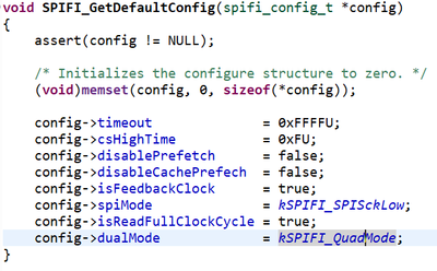

  1. How to change the MODE of SPI in MCUXPRESSO?
Do you mean SPIFI? If that’s the case, then you could change it as follows:
  1. First, you need to select the drivers to work with SPIFI. In new project -> drivers -> SPIFI and check the box. Then in the file fsl_spifi.c modify the next function in the highlighted line.
As mentioned in the answer of your first question, you can modify between QUAD and DUAL:

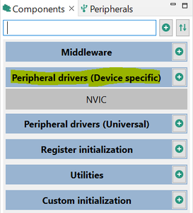

  1. In MCUXpresso there is a useful tool called ConfigTools, if you are aware of how it works, you could use Peripherals
And trough Peripheral drivers add SPIFI and configure it according to your needs. In SPI Protocol you could select between QUAD and DUAL.
Do not forget to Update the code.
