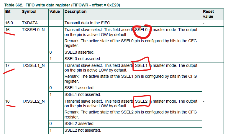

Hello everybody,
On my custom LPC55xx based board I'm trying to communicate via a single SPI interface with several slaves (SSEL0 - SSEL2).
The MCU obviously supports this as the FIFO Write register contains bits to select the slave for a transfer.
FIFOWR provides the possibility of altering some SPI controls at the same time as
sending new data.
Do the SDK drivers support this and how?

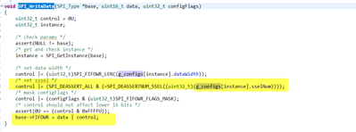

I gleaned from the source code fsl_spi.h that the slave number is encoded in a struct spi_master_config_t and this struct is used when calling SPI_MasterInit(). According to fsl_spi.h, the slave number is not used when doing a transfer. So it seems it is not possible to easily switch between slaves from one transfer to another.

Hello Daniel,
The SDK SPI driver support multiple slaves. I have reply you on your private case.

I appreciate your reply. However, I have to disagree. I can not find any API functions to select a different slave for each transaction short of calling the init function again (as I mentioned before).
I'm using Peripherals Tool and selected "Universal Driver" for Flexcomm. This generates initialization code based on the CMSIS driver. The CMSIS driver is not using SPI_WriteData() but SPI_MasterTransferNonBlocking() and SPI_TransferHandleIRQInternal() in fsl_spi.c.
The latter includes this piece of code:
    /* select slave to talk with */
    tx_ctrl |= ((uint32_t)SPI_DEASSERT_ALL & (uint32_t)SPI_ASSERTNUM_SSEL(handle->sselNum));
    /* set width of data */
    tx_ctrl |= SPI_FIFOWR_LEN(handle->dataWidth);
That is, in each interrupt request, the slave is selected according to handle->sselNum.
A quick solution is to add an API call (to fsl_spi_cmsis.c) in order to change sselNum.
uint8_t SPI3_getSSEL() {
    return SPI3_InterruptDriverState.handle->masterHandle.sselNum;
void SPI3_setSSEL(uint8_t slave) {
    SPI3_InterruptDriverState.handle->masterHandle.sselNum = slave;
This sets sselNum of Flexcomm3. Should be called before a call to Transfer().
Further resource locking is recommended.

Hello danielholala,
The slave number is used in SPI_WriteData() function:
So if you want to use more than one slave, you need change the number for call this data write function.
