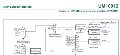

I can't understand the clocking system of SCTimer/PWM module in LPC546XX MCUs.
CLKMODE=0x0 selects system clock for SCTimer counter clocking. Is this clock divided by SCTCLKDIV or not?
For example, if I have a system clock of 220MHz (on LPC54628) and SCTCLKDIV=1 (divide by 2), what is the SCTimer counting clock frequency? 220MHz or 110MHz? It seems to me it is always 220MHz, so it doesn't depend on SCTCLKDIV.
It is strange, because CLOCK_GetSctClkFreq() returns 110MHz, but I think its 220MHz.
When SCTCLKDIV is used? Only if I use CLKMODE=0x2 or 0x3 and CLKSEL=0xE or 0xF (Input 7 as the clock)?
I also read another note:
Remark: The maximum frequency for the SCTimer/PWM clock is 100 MHz.
If I have a system clock of 220MHz, couldn't I use CLKMODE=0x0 (counter clocked by system clock, apparently without divider)?

I agree with you, if you set up CLKMODE=0x0 , the system clock is selected as tick for the SCTimer counter, the system clock is the CPU clock as the following fig rather than SCT_IN7 clock. So if you select the CLKMODE=0x0, you can NOT change the SCT clock with changing the SCTCLKDIV value.
There is a remark that the SCT clock maximum frequency is 100MHz, pls refer to 16.3 Basic configuration in UM10912.pdf
Hope it can help you
XiangJun Rong
