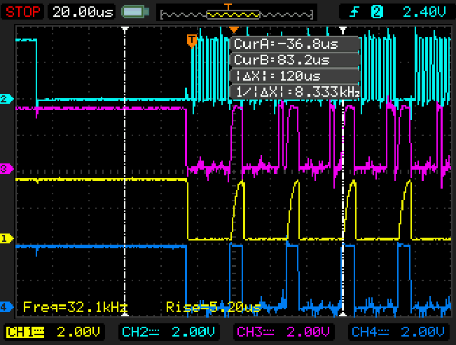

I have a number of questions about SPI slave mode on the LPC11U6x, which are not answered in the user manual. Most of them are concerned with the correct TX of data (which is more challenging for the slave side of SPI).
  • If the TX FIFO is empty, what is transmitted on MISO -- 0x00, 0xFF, or a repeat of the previous byte?
  • If SSEL is deasserted while the TX FIFO still contains data, is the TX FIFO flushed?
  • Can I flush the TX FIFO?
  • Can I preload the TX FIFO with data while SSEL line is idle?
  • Is it possible to detect TX underflow?
  • Can I get an interrupt as soon as the SSEL line is asserted? (so that I know I need to prepare data to be read). Either from the SSP, or from the PINT.
    • Is it possible to configure a pin for PINT if the pin is configured for a function other than GPIO? Or, would I need to connect the SSEL line to a second pin to provide the PINT functionality?

 1   If the TX FIFO is empty, what is transmitted on MISO -- 0x00, 0xFF, or a repeat of the previous byte?
= I have tested it, it should be 0X00 if none data input to the transmit buffer, this is my test result
The yellow wave is the MISO, you can find it is the 0x00.

CraigMcQueen
I have tested this further. If I transmit data, then stop writing to TX FIFO, and the TX FIFO underflows, then it appears that the SPI repeatedly transmits whatever was the 8th-most-recent byte sent (I guess because that's the next byte in an 8-byte circular FIFO).
E.g., if I write to the TX FIFO with:
0x01, 0x02, 0x03, 0x04, 0x05, 0x06, 0x07, 0x08, 0x09, 0x0A
... and then stop writing to the TX FIFO, but the SPI master continues clocking out, then it will transmit:
0x01, 0x02, 0x03, 0x04, 0x05, 0x06, 0x07, 0x08, 0x09, 0x0A, 0x03, 0x03, 0x03, 0x03, ...
That's not ideal, but now that I know it, I'll work with that.
