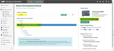

Hello ,
Download SDK,  https://mcuxpresso.nxp.com/en/select
choose chip/board and IDE, it support MCUXpresso IDE, IAR and KEIL.

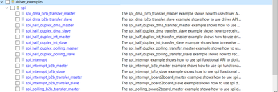

After download, you can find ISP demos under driver_examples.
Hope it helps.
