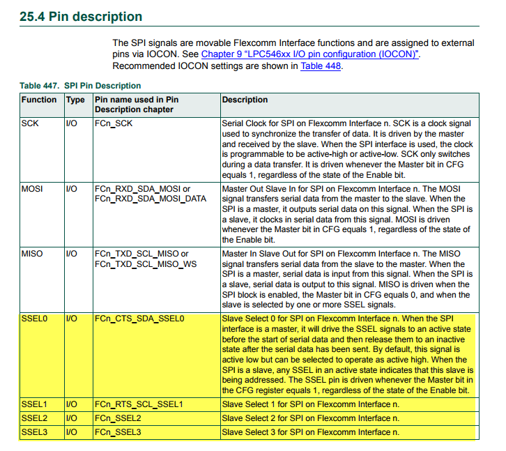

soledad
This device has four Slave Select input/outputs with selectable polarity and flexible usage.

hlsamts
If someone asks you about the color of an apple, are you going to tell her/him that a banana is yellow?!
No.
Your response does not answer the question.
