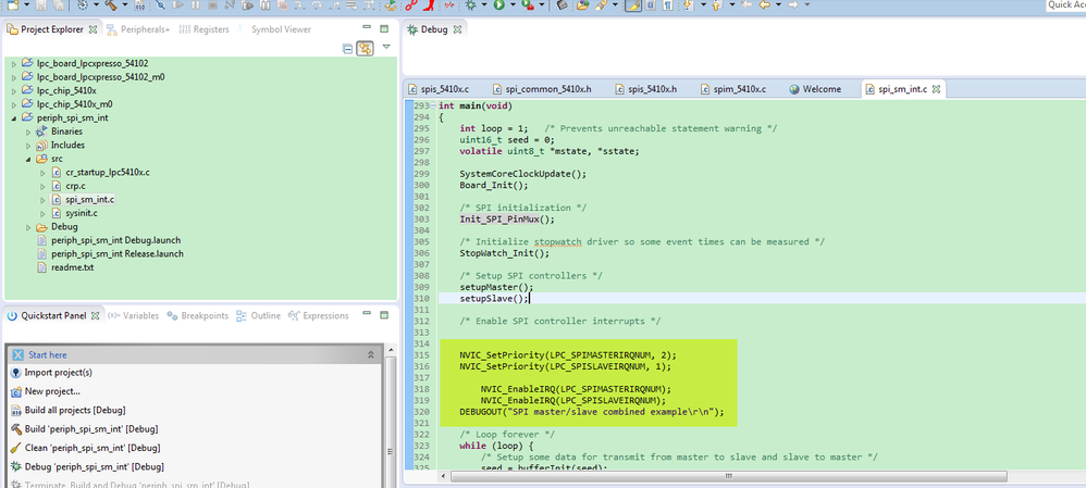

       I have LPCXpresso 54102 LQFP64 Rev A (OM13077) development board & using LPCXpresso_8.1.0_597 IDE.
It is running with Cortex M4 processor at 96MHz.
I am executing the default example program "periph_spi_sm_int" to validate SPI protocol with master and slave.
After every transaction if i call the function setupMaster() then only it is working fine, otherwise it is giving wrong values. But for the general SPI communication this function( setupMaster() ) call is not required for every transmission of data because it is only needed at the time of initialization. So please suggest me your ideas whether it is required every time or not ?

Hello Ratheesh T,
   Answer your two questions:
1. SPI can't receive the correct data in the periph_spi_sm_int sample code
Answer: The solution is  making SPI SLAVE IRQ has higher priority than master IRQ
Please add these codes before while(loop) :
NVIC_SetPriority(LPC_SPIMASTERIRQNUM, 2);
NVIC_SetPriority(LPC_SPISLAVEIRQNUM, 1);
/* Enable SPI controller interrupts */
NVIC_EnableIRQ(LPC_SPIMASTERIRQNUM);
NVIC_EnableIRQ(LPC_SPISLAVEIRQNUM);
It just like this:

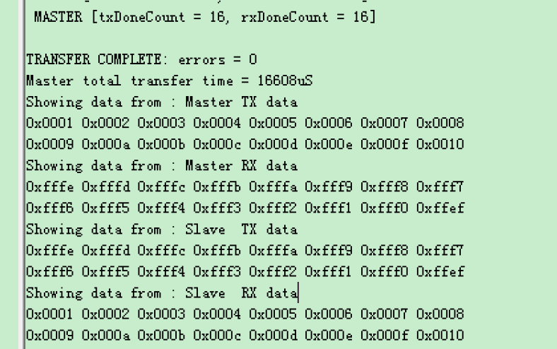

At last, the printf data is:
2. call the function setupMaster()
Actually, just like the official code, you just need to call setupMaster() once, then you don't need to call it any more.
I have test it on my side, after add the item 1 code.
each time, I will get the correct data.
These are the three round test result:

I also attached my modified code for your reference.
Wish it helps you!
Please try again, if you still have question, please let me know.
