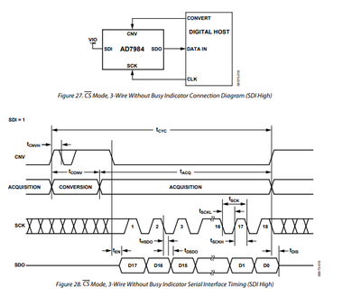

Hi all,
I am trying to use the SPI protocol to communicate between my board (LPC55S06-EVK) and an external ADC (EVAL-AD7984 from Analog Devices). I have attached the page from the datasheet of my ADC to show you how the SPI communication works so that you can understand my code given below (I have also attached my entire source file). My question is this: how do I enable (start) and disable (stop) the SPI SCK from running? First, does the function CLOCK_AttachClk start the clock signal on SPI SCK? Second, what function should I use to stop the SPI SCK?
If I am going about this the wrong way, please point me in the right direction.
(My next question, which is probably for another community post, is how do I input the data from the EVAL board via the SPI MISO back to my NXP board and interpret it?)

Hi, Caden,
Regarding your question, I think your code is too complicated.
As you connect 3 signals to the AD7984, I suggest you connect the SSELx  of LPC5506 to CONV of ADC, connect the SCK of LPC to SCK pin of ADC, connect the MISO  pin of LPC to SDO of ADC. You do not need any GPIO or SCT modules.
The high width of SSEL can be controlled by the TRANSFER_ DELAY bits of SPI delay register.
Because the width of data is 18 bits, so you have to transfer twice for example, transfer 8 bits first times with EOT bit of FIFOWR register cleared, transfer remaining 10 bits in second times with EOT bit set, after the second transfer, the SSEL signal will becomes high with the time defined by TRANSFER_ DELAY.
I hope you write the SPI register directly without calling the SDK function.
Regarding the CLOCK_AttachClk() function, it select the SPI driving clock, the SCK clock is from the clock defined by CLOCK_AttachClk() with a baudrate divider as Frank said.
No, it doesn't. It only enables the peripheral unit.
The SCK signal start when you write to the Tx register. In this case, usually the FIFOWR register.
None. When the transfer according to the current SPI configuration is finished, SCK stops automatically.

caden013
The external ADC (EVAL-AD7984) that I am using does not have a usable SDI (MOSI) pin (the SDI pin is tied to logic 1). I have connected an LED to the SCK pin header to see if my clock signal is being propagated, and I cannot determine that it is. You said that I needed to write to the FIFOWR register to turn on the clock, so I used the function "SPI_WriteData," which did not turn on my clock signal. Then, I tried using the instruction "SPI3->FIFOWR = 1," but again it did not work.
I used the function "SPI_ReadData" to input the ADC values, but my results are always 0. I assume that if I fix my clock signal, I will at least see values other than 0.
Sorry for my novice understanding, but I appreciate your help.
Which is no problem, the device does not need input. The transmit data are irrelevant in this case.
If you are using normal clock speeds, you will not see anything. This is just plain physiology of the human eye. You would need a scope.
The SPI interface must be properly initialized (clocks enables, pins configured).
Aren't there SDK examples for the SPI interface ? Building and running one should be no problem. If you connect to ADC board to this SPI interface, you should at least be able to observe the signals, even if it is not according to the ADC datasheet.
If the connections are electrically/logically correct, nothing breaks. From there, you can start to modify it, to get your ADC running.
