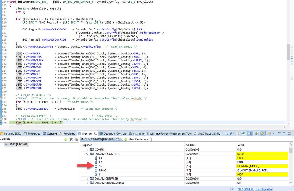

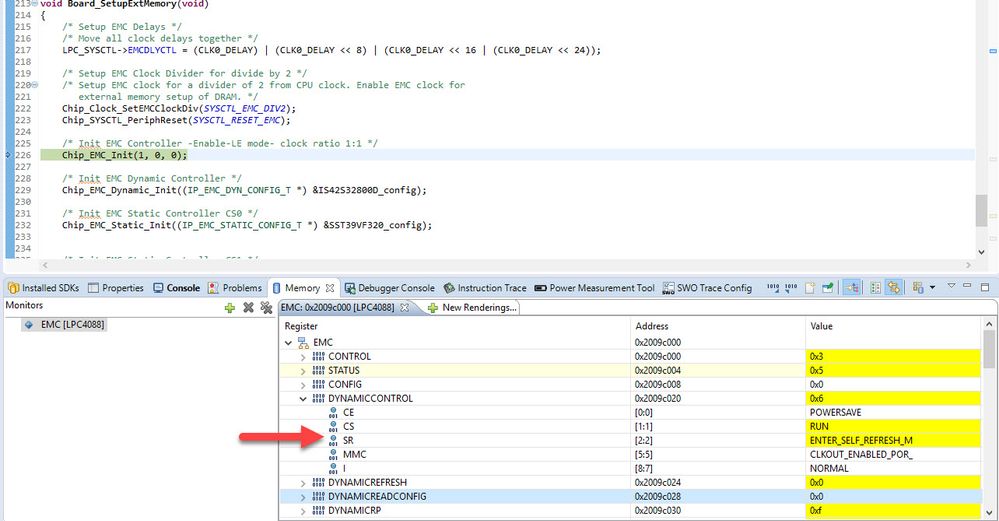

victorjimenez
Hello Vincent LE GARREC,
Regarding your doubt that you are not sure you are actually entering the self-refresh mode. I was checking the example periph_memtest  of the LPCOpen. And when you reset the EMC module you go into self-refresh mode, I was able to see this change directly in the registers.
And after, in  the function initDynMem once you make all the configurations of the memory you change to normal mode by just writing to the DynamicControl register. At this point I'm able to see also in the register that I enter successfully to normal mode.
Are you able to see these changes in your registers? This way you can be sure that you enter/exit correctly the self-refresh mode.
