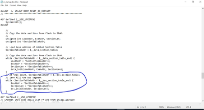

xiangjun_rong
As the following screenshot, in the cr_startup_lpc43xx.c file, the bss section is initialized as 0.
BTW, as you know the SDRAM is RAM, volatile memory, it can not save constant data, the constant must be saved in flash, and copy to RAM as the following code.
Hope it can help you
XiangJun Rong

frank_m
Senior Contributor III
It shouldn't be too difficult to modify the startup code, and initialize the EMC before the constants (Flash data) are copied.
