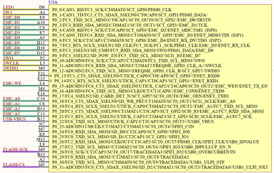

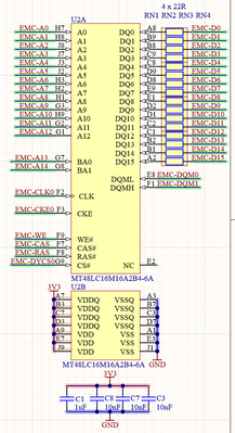

I use this in my designs:
This is my board.c file:

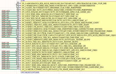

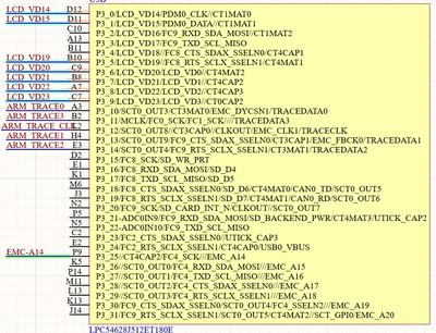

	/* A0 to A14 */
	IOCON_PinMuxSet(IOCON, 0, 18, (IOCON_FUNC6 | IOCON_MODE_INACT | IOCON_DIGITAL_EN | IOCON_PIO_SLEW_FAST));
	IOCON_PinMuxSet(IOCON, 0, 19, (IOCON_FUNC6 | IOCON_MODE_INACT | IOCON_DIGITAL_EN | IOCON_PIO_SLEW_FAST));
	IOCON_PinMuxSet(IOCON, 0, 20, (IOCON_FUNC6 | IOCON_MODE_INACT | IOCON_DIGITAL_EN | IOCON_PIO_SLEW_FAST));
	IOCON_PinMuxSet(IOCON, 0, 21, (IOCON_FUNC6 | IOCON_MODE_INACT | IOCON_DIGITAL_EN | IOCON_PIO_SLEW_FAST));
	IOCON_PinMuxSet(IOCON, 1,  5, (IOCON_FUNC6 | IOCON_MODE_INACT | IOCON_DIGITAL_EN | IOCON_PIO_SLEW_FAST));
	IOCON_PinMuxSet(IOCON, 1,  6, (IOCON_FUNC6 | IOCON_MODE_INACT | IOCON_DIGITAL_EN | IOCON_PIO_SLEW_FAST));
	IOCON_PinMuxSet(IOCON, 1,  7, (IOCON_FUNC6 | IOCON_MODE_INACT | IOCON_DIGITAL_EN | IOCON_PIO_SLEW_FAST));
	IOCON_PinMuxSet(IOCON, 1,  8, (IOCON_FUNC6 | IOCON_MODE_INACT | IOCON_DIGITAL_EN | IOCON_PIO_SLEW_FAST));
	IOCON_PinMuxSet(IOCON, 1, 26, (IOCON_FUNC6 | IOCON_MODE_INACT | IOCON_DIGITAL_EN | IOCON_PIO_SLEW_FAST));
	IOCON_PinMuxSet(IOCON, 1, 27, (IOCON_FUNC6 | IOCON_MODE_INACT | IOCON_DIGITAL_EN | IOCON_PIO_SLEW_FAST));
	IOCON_PinMuxSet(IOCON, 1, 16, (IOCON_FUNC6 | IOCON_MODE_INACT | IOCON_DIGITAL_EN | IOCON_PIO_SLEW_FAST));
	IOCON_PinMuxSet(IOCON, 1, 23, (IOCON_FUNC6 | IOCON_MODE_INACT | IOCON_DIGITAL_EN | IOCON_PIO_SLEW_FAST));
	IOCON_PinMuxSet(IOCON, 1, 24, (IOCON_FUNC6 | IOCON_MODE_INACT | IOCON_DIGITAL_EN | IOCON_PIO_SLEW_FAST));
	IOCON_PinMuxSet(IOCON, 1, 25, (IOCON_FUNC6 | IOCON_MODE_INACT | IOCON_DIGITAL_EN | IOCON_PIO_SLEW_FAST));
	IOCON_PinMuxSet(IOCON, 3, 25, (IOCON_FUNC6 | IOCON_MODE_INACT | IOCON_DIGITAL_EN | IOCON_PIO_SLEW_FAST));
	/* D0 to D15 */
	IOCON_PinMuxSet(IOCON, 0,  2, (IOCON_FUNC6 | IOCON_MODE_INACT | IOCON_DIGITAL_EN | IOCON_PIO_SLEW_FAST));
	IOCON_PinMuxSet(IOCON, 0,  3, (IOCON_FUNC6 | IOCON_MODE_INACT | IOCON_DIGITAL_EN | IOCON_PIO_SLEW_FAST));
	IOCON_PinMuxSet(IOCON, 0,  4, (IOCON_FUNC6 | IOCON_MODE_INACT | IOCON_DIGITAL_EN | IOCON_PIO_SLEW_FAST));
	IOCON_PinMuxSet(IOCON, 0,  5, (IOCON_FUNC6 | IOCON_MODE_INACT | IOCON_DIGITAL_EN | IOCON_PIO_SLEW_FAST));
	IOCON_PinMuxSet(IOCON, 0,  6, (IOCON_FUNC6 | IOCON_MODE_INACT | IOCON_DIGITAL_EN | IOCON_PIO_SLEW_FAST));
	IOCON_PinMuxSet(IOCON, 0,  7, (IOCON_FUNC6 | IOCON_MODE_INACT | IOCON_DIGITAL_EN | IOCON_PIO_SLEW_FAST));
	IOCON_PinMuxSet(IOCON, 0,  8, (IOCON_FUNC6 | IOCON_MODE_INACT | IOCON_DIGITAL_EN | IOCON_PIO_SLEW_FAST));
	IOCON_PinMuxSet(IOCON, 0,  9, (IOCON_FUNC6 | IOCON_MODE_INACT | IOCON_DIGITAL_EN | IOCON_PIO_SLEW_FAST));
	IOCON_PinMuxSet(IOCON, 1, 19, (IOCON_FUNC6 | IOCON_MODE_INACT | IOCON_DIGITAL_EN | IOCON_PIO_SLEW_FAST));
	IOCON_PinMuxSet(IOCON, 1, 20, (IOCON_FUNC6 | IOCON_MODE_INACT | IOCON_DIGITAL_EN | IOCON_PIO_SLEW_FAST));
	IOCON_PinMuxSet(IOCON, 1, 21, (IOCON_FUNC6 | IOCON_MODE_INACT | IOCON_DIGITAL_EN | IOCON_PIO_SLEW_FAST));
	IOCON_PinMuxSet(IOCON, 1,  4, (IOCON_FUNC6 | IOCON_MODE_INACT | IOCON_DIGITAL_EN | IOCON_PIO_SLEW_FAST));
	IOCON_PinMuxSet(IOCON, 1, 28, (IOCON_FUNC6 | IOCON_MODE_INACT | IOCON_DIGITAL_EN | IOCON_PIO_SLEW_FAST));
	IOCON_PinMuxSet(IOCON, 1, 29, (IOCON_FUNC6 | IOCON_MODE_INACT | IOCON_DIGITAL_EN | IOCON_PIO_SLEW_FAST));
	IOCON_PinMuxSet(IOCON, 1, 30, (IOCON_FUNC6 | IOCON_MODE_INACT | IOCON_DIGITAL_EN | IOCON_PIO_SLEW_FAST));
	IOCON_PinMuxSet(IOCON, 1, 31, (IOCON_FUNC6 | IOCON_MODE_INACT | IOCON_DIGITAL_EN | IOCON_PIO_SLEW_FAST));

    /* Dynamic memory chip specific configuration: Chip 0 - MTL48LC8M16A2B4-6A */
    dynChipConfig.chipIndex       = 0;
    dynChipConfig.dynamicDevice   = kEMC_Sdram;
    dynChipConfig.rAS_Nclk        = SDRAM_RAS_NCLK;
    dynChipConfig.sdramModeReg    = SDRAM_MODEREG_VALUE;
    dynChipConfig.sdramExtModeReg = 0; /* it has no use for normal sdram */
    dynChipConfig.devAddrMap      = SDRAM_DEV_MEMORYMAP;
