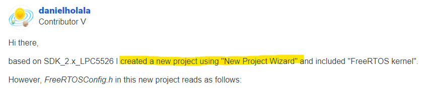

Hi there,
based on SDK_2.x_LPC5526 I created a new project using "New Project Wizard" and included "FreeRTOS kernel".
However, FreeRTOSConfig.h in this new project reads as follows:
#ifdef __NVIC_PRIO_BITS
/* __BVIC_PRIO_BITS will be specified when CMSIS is being used. */
#define configPRIO_BITS __NVIC_PRIO_BITS
#else
#define configPRIO_BITS 4 /* 15 priority levels */
#endif
That's wrong as Cortex-M33 core only uses 3 bits for interrupt priority.
The examples get it right. I assume that I should use an example's FreeRTOSConfig.h as starting point
So why does the New Project Wizard fail to include a correct FreeRTOSConfig.h ?

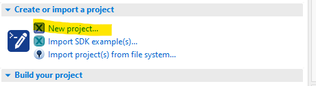

Back to the issue at hand: Of course, I created the project using different steps:
I assume you missed that. Please try again using the "New project..." wizard here:
You'll see that completely different code for FreeRTOSConfig.h (at least, haven't checked other files) will be pulled into the new project.

Hi Carlos,
obviously you are executing different steps.
You wrote that you did: "create new project (File --> Project --> import SDK example "
That's importing an SDK example. And by the way, you are referring to the "File" menu but there's no "Project" submenu in there.
That being said, what I did was using "Quickstart Panel" and there "New project...".
Did you try this?

danielholala
Senior Contributor II
Dear @CarlosGarabito ,
For the sake of correctnes: creating a new project and importing an SDK example are two different processes. When you say that you are creating a new project but at the same time recite steps import an SDK example your wording is ambiguous. That's not helpful.
Let's look at the User Manual as the reference for wording regarding MCUXpresso IDE:
Mind you, the issue I'm observing occurs only when you create a new project ("Quickstart Panel -> New Project..."). It does not occur when you import an SDK example.
This is likely a bug. Please try to recreate the issue that I'm observing. If you can confirm then forward the report to the SDK team.
