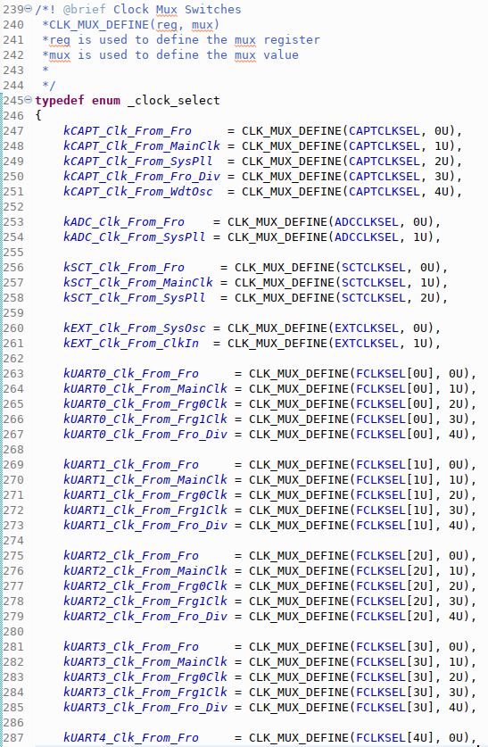

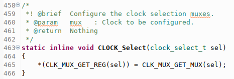

In fsl_clock.h of the above SDK usually is a driver function to select a clock source for a peripheral:
with intended parameters of type clock_select_t:
and so on.
But there is no member like kWKT_Clk_From_Lposc or so.
So do I have to select the clock source like PMU->DPDCTRL |= 4; ???

Hi ,
1) So do I have to select the clock source like PMU->DPDCTRL |= 4; ?
-- Yes.

1234567890
Thanks.
Will there be a driver function like
CLOCK_Select(kWKT_Clk_From_Lposc)
be available in near future? I think enabling all clock sources except low power oscillator is not consequent.

Hi ,
Thanks for your suggestion, and I'll report it in the next round of field trial of the SDK library.\
