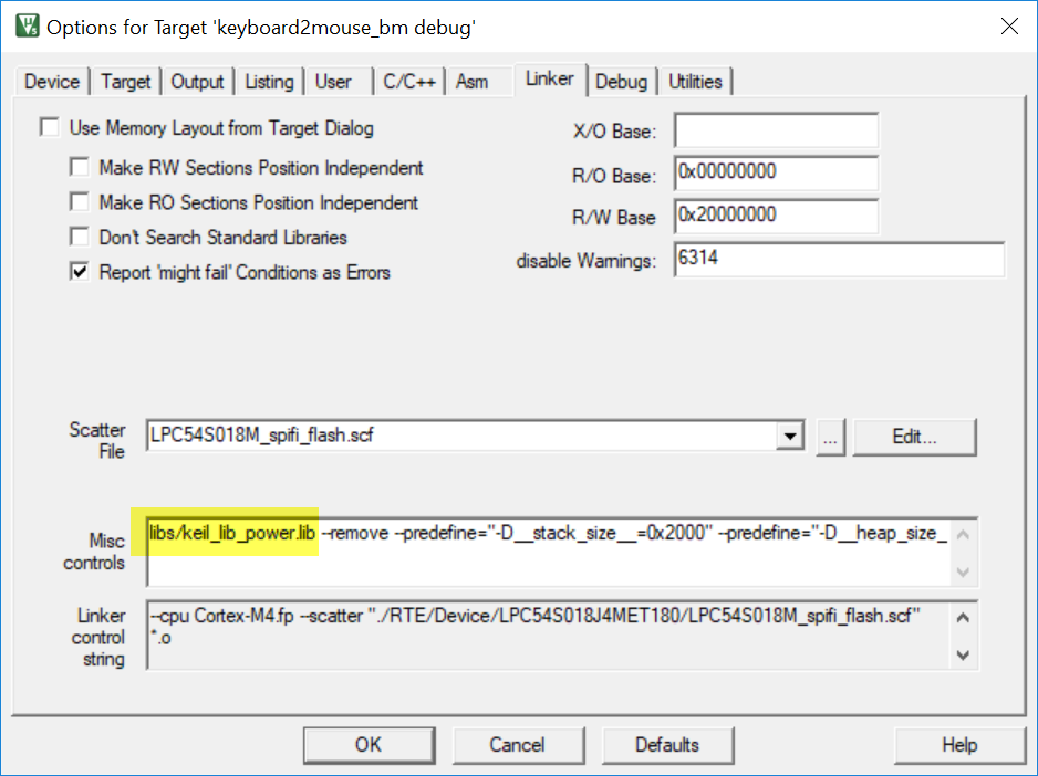

I downloaded the latest standalone project (keyboard2mouse_bm) for LPC54S018M-EVK board for KEIL IDE. The project does not longer build correctly If you attempt to build the project your get the following error:
debug\keyboard2mouse_bm.out: error: L6002U: Could not open file ../../../../../../devices/LPC54S018M/arm/keil_lib_power.lib: No such file or directory
This is because the project has a dependency (keil_lib_power.lib) that is pointing outside of the project's directory (../../../../../../devices/LPC54S018M/arm/). This project used to build fine under SDK 2.5.0.

You are not testing the STANDALONE version. You are testing the SDK full blown version.The STANDALONE version is broken.
Please go into SDK BUILDER webpage and download the standalone version of the project; then you will see it does not build. I 've attached the STANDALONE version I downloaded from SDK BUILDER

I just tested standalolne project I reproduce your issue.
this is a path setting error.
I modify the path I can remove the error:
I will report the issue. Thanks for bringing the problem to our attention.
