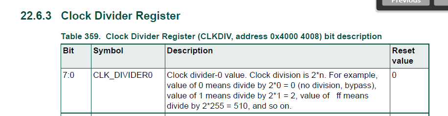

   Because, if refer to the user manual:
div = ((clk_rate / speed) + 2) >> 1; is correct.
clk_rate/speed= (div*2-2)=(div-1)*2
So, I think we also need to check clk_rate, whether it is correct or not.

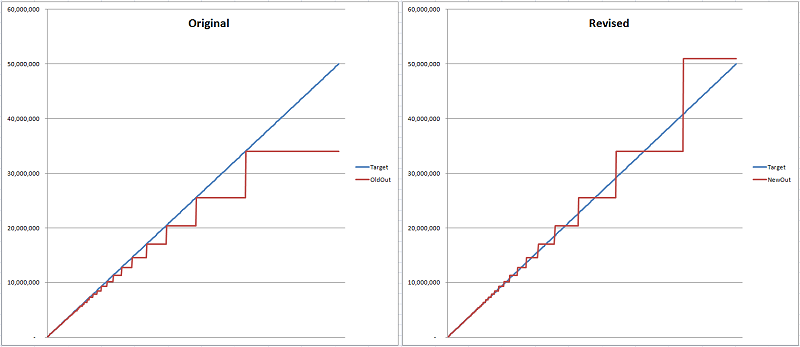

Plugging in the formula from the reference manual it looks like my formula gives the better answer:
Original:
204,000,000 / (2 * 256) =      398,438 (can't actually be set, 256 doesn't fit in the register so it was really 204MHz I guess)
204,000,000 / (2 * 6)     = 17,000,000 (15% error)
204,000,000 / (2 * 5)     = 20,400,000 (18% error)
204,000,000 / (2 * 3)     = 34,000,000 (32% error)
Revised:
204,000,000 / (2 * 255) =      400,000 (0% error)
204,000,000 / (2 * 5)     = 20,040,000 (2% error)
204,000,000 / (2 * 4)     = 25,500,000 (2% error)
204,000,000 / (2 * 2)     = 51,000,000 (2% error)
Adding + 1 picks the nearest divisor resulting in the best match, adding + 2 rounds up the divisor which overshoots the division rate in all cases other than exact multiples.
Here's a plot in 100KHz increments with blue as the target and red as the actual output:
Swept over the range, the average error is halved in the revised version.
