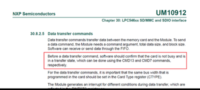

Thank you for your input. I already tried sending CMD13 after write and also CMD7 as per LPC datasheet recommend. No change.
I have also added delays between writes without sucess. I think there is a magic command windows and Linux send after file or floder access which forces the sd to program its cached data. Maybe manual erasing one or more dummy blocks by SD_EraseBlocks() will trigger the lazy sd controller to start programming. Do you think filesystem do such thing while updating FAT?

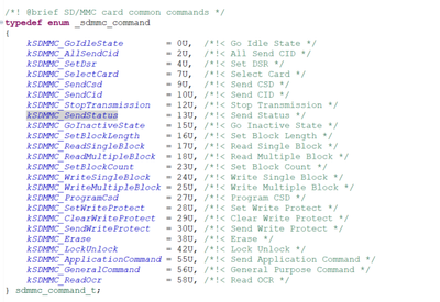

How does it work if explicit flush by CMD38 to triger SD card?
 I don't think windows/linux use magic command. All the available commands are listed here:
