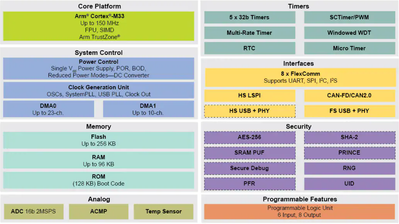

I need to connect an SD Card to the LPC55S14 micro. (Not for booting - just temp data storage.) A last minute addition to an almost completed design.
I don't see a native SD Card capability listed in the Datasheet or the User Guide.
Any help would be appreciated - documentation, diagrams, recommendations...
1,511 Views
ZhangJennie
LPC55S1x doesn't support SDHC/SDIO interface. That's why you can't see document and demo code on this usage.
For LPC551X/S1x, the supported Block Diagram is as below:
Hope this helps,
