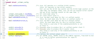

The _sctimer_config (fsl_sctimer.h) contains a configuration variable to define the initial values of the output pins called "outInitState". This is defined as an 8 bit value, but the SCTimer has 10 output pins. Can you please make this a 16 bit variable, to support SCT output 8 and 9?

Hello ArnodeJ,
Yes, you are right. I will take a ticket to SDK team, and now you can first change it on your side:
