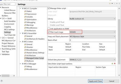

Hello @A_M
Enabling the “Plain load image” will program main code into flash, and execute in RAM:

A_M
Hello
Unfortunately it does not work because PROGRAM_FLASH is the first on the flash order.
