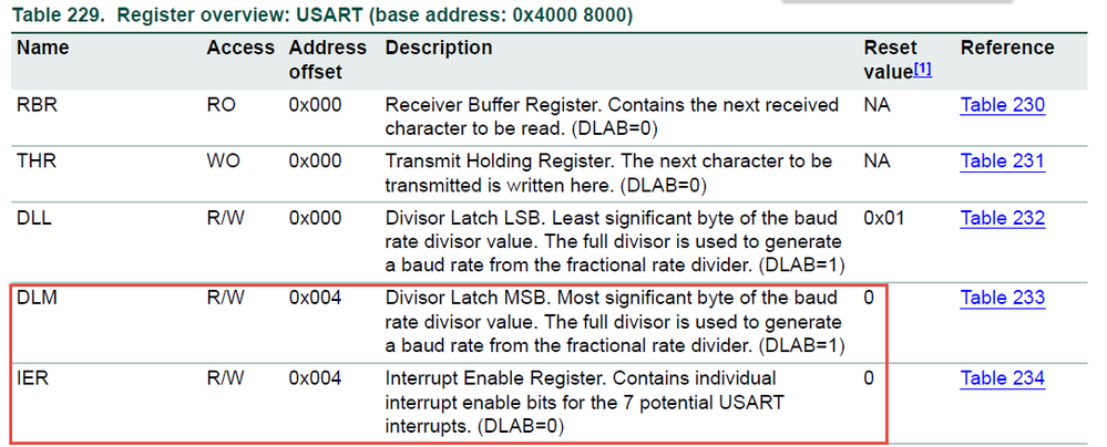

Hi! I am using LPC11uxx and trying to configurate UART smart card mode. When I filled register DLM value, IER also fiiled by the same value? Is it normal? If yes, why it is happens?

1) When I filled register DLM value, IER also filled by the same value?
-- Yes, their address is identical, however, the value of DLAB bit determine the writing value be valid or not.
