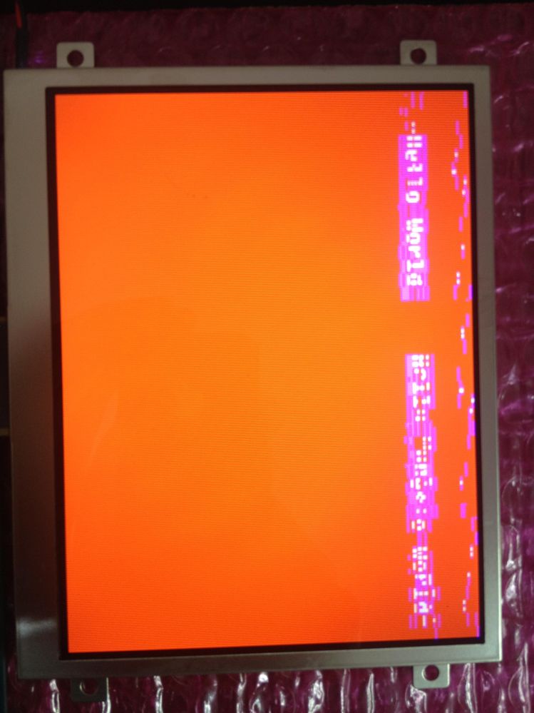

poptelecanconst
Hello again,
  This is a picture with the output on the screen.
  I am trying to write "Hello World" just once - but  appears twice, 3 times ...
 All day I checked the lines again. I connected pin 34 (Data Enable) to GND. As mentioned in datasheet at page 8 - "DE signal is fixed low for SYNC mode ".
  Now vsync and hsync has an impact (when changed in code). Also pulse moves the image up/down, right / left.
  I still have the problem (always did) wit that tearing / double / triple content. I am in progress of troubleshooting the SDRAM.
  Please remember I have a single external SDRAM module, NOT 2. I searched everywhere , and seems that 2 x 16 bit modules are needed for LCD , but I would love to make this work as it is.
  After the picture I've attached the source code for SDRAM init. I am sure I will be asked about it ...
  Thankyou again.

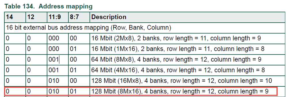

void SDRAM_Init (void)
    uint32_t i, dwtemp = dwtemp;
    uint16_t wtemp = wtemp;
       uint32_t mhz, nsPerClk;
    /* Enable External Memory Controller power/clock */
LPC_SC->PCONP      |= 0x00000800;
LPC_SC->EMCDLYCTL   = 0x00001010;
//LPC_SC->EMCCLKSEL=0;    //60 MHZ
LPC_SC->EMCDLYCTL   = 0x00080808;
LPC_EMC->Control    = 0x00000001;
LPC_EMC->Config     = 0x00000000;
    EMC_GPIO_Init();
     mhz = SystemCoreClock / 1000000;
LPC_EMC->DynamicConfig0    = 0x00000480; /* 128B, 8Mx16, row=12, 4 banks,  column=9 */
//Timing for 120MHz Bus: 8.333333 ns/clk
LPC_EMC->DynamicRasCas0    = 0x00000302; // 3 RAS, 3 CAS latency */
LPC_EMC->DynamicReadConfig = 0x00000001; /* Command delayed strategy, using EMCCLKDELAY */
LPC_EMC->DynamicRP         = 0x00000003; // Min 20ns. (n + 1) -> 3 clock cycles
LPC_EMC->DynamicRAS        = 0x00000006; // Min 44 ns.(n + 1) -> 6 clock cycles
LPC_EMC->DynamicSREX       = 0x0000000A; // Min 75 ns. ( n + 1 ) -> 10 clock cycles */
LPC_EMC->DynamicAPR        = 0x00000005; // ??? ( n + 1 ) -> 2 clock cycles */
LPC_EMC->DynamicDAL        = 0x00000006; // tWR + tRP: min 35 ns (n + 1) -> 5 clock cycles */
LPC_EMC->DynamicWR         = 0x00000002; // Min 15 ns. ( n + 1 ) -> 2 clock cycles */
LPC_EMC->DynamicRC         = 0x00000008; // Min 66 ns. ( n + 1 ) -> 8 clock cycles */
LPC_EMC->DynamicRFC        = 0x00000008; // Min 66 ns. ( n + 1 ) -> 8 clock cycles */
LPC_EMC->DynamicXSR        = 0x0000000A; // Min 75 ns. ( n + 1 ) -> 10 clock cycles */

poptelecanconst
Hello everyone !
  With GREAT JOY I must update you that I FINALLY solved the problem. Took me over 40 hours of study and debug ... for such a simple solution.
  As you may guess ... YES dumb me I initialized WRONG the memory address mapping.
 In UM10470 at page 196 (table 134 , address mapping) ->
  LPC_EMC->DynamicConfig0    = (1 << 14) |  /* AM[14]   = 1                   */
                               (1 << 12) |  /* AM[12]   = 0                   */
                               (2 <<  9) |  /* AM[11:9] = 2                   */
                               (0 <<  7) ;  /* AM[8:7]  = 1                   */‍‍‍‍
THAT is 128Mbit (8Mx16) 4 banks row length =12 column = 10
I hope it will help someone with the same problem as me. This was a single line of code that took me to a 5 day non-stop trouble-shooting, measuring, testing, trace observation, code debug ....
THANKYOU everyone so much !
Popte.
3,022 Views
jeremyzhou
According to the AS4C8M16SA's datasheet, it's a 16-bit wide memory whose row and column length is 12 and 9 respectively.
So in my opinion, it should be configured as the following figure shows.
TIC
3,022 Views
poptelecanconst
Hi Jeremy and Many Thanks for Your message.
   I got an email (a notification) from NXP community yesterday, on my phone, while I was in the city, that someone added a reply.
  I read the reply and HONESTLY I was SCARED to even try anyhing. Just because I was sure that I will break things again (not by changing a line of code, but because I realised you are 100% right in theory, and I was scared it WON'T work). And then ... my nightmare would start again. Re-calculate and re-think the ... timings to figure out WHY.
 OK, this evening I decided ... what the hell. I should try it. And I did. AND YES. WORKS.
Yes you are 100% correct. Thankyou for your great observation. It would have been produced with my euroneus initialization, and maybe later on something bad would have happened.
Now ... so I won't live in ignorance, I will spend this night to try to find out (and understand) WHY it has been working with my init ... I will report back.
        Thankyou verry much.
I wish you all the best, and alot of health !
Popte.
