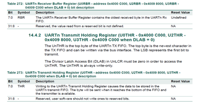

For usart module, it can transmit or receive only ONE byte, pls refer to the usart data registers:
So the Usart will trigger interrupt after it has received/transmitted a Byte.
I see that your data is half word(16 bits), I think you can transfer the half word(temperature variable) with two byte.

I suggest you delete the line  uint8_t len=sprintf((char*)buffStr,"Hello.Temp is %u\n %u\n",temp, data1);
You can transfer data directly. The 0xFFFF is a separator or mark so that the receiver know which is high byte which is low byte.
Hope it can help you
