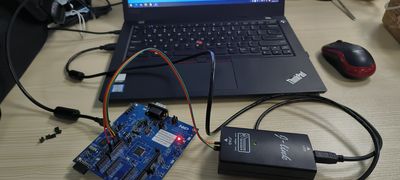

      We programed a hex file to LPC55S06 (official demo) by J-Flash (v7.56 or v8.82f, connecting with Jlink v9) tool at the first time, then we readed back "Entire chip" sucessfully.
      Then, we ereased chip and re-programed the chip by the same hex file; After that, we tried to read back "entire chip", but it failed.
      We tried all the configurations in J-Flash tool, but failed to read back again.
      We can't find the reason, and this problem will affect our production.
      Hope you can help us to fix it.
      Thanks very much.
 ----hardware link
----read back "entire chip"
----read back error from the second time

Hello All,
Yes,When reading an erased location, an uncorrectable error is flagged. Use the “blank
check” command to test for a successful erase.
About detail description, you can refer to:
https://community.nxp.com/t5/LPC-Microcontrollers-Knowledge/LPC55xx-Erased-Memory-State-0-or-1/ta-p/...

Hello @jimmyli
What image did you programed?
How about erase? How about read sector?
And how about enter ISP mode, using Blhost to read? I ask this just want to confirm it is tool issue or MCU.
Alice
4,805件の閲覧回数
jimmyli
Contributor V
Hi Alice,
hex image
Erase: J-Flash-->Target-->Manual Program-->Erase Chip
Read:  J-Flash-->Target-->Manual Program-->Read back-->Entire Chip
using SWD interface, not by ISP mode.
Thanks very much.
4,815件の閲覧回数
Johnson_Ho
same issue: when a sector has been erasered, the j-flash can not readback the sector; the read back only works while the sector has been programed something.
