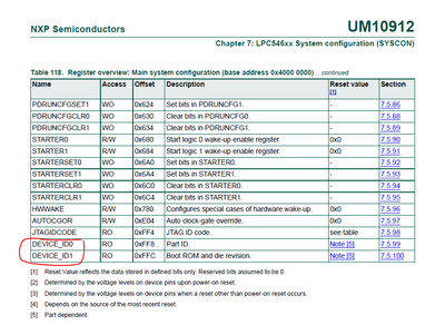

At least in my LPC54xxx user manual, it is easy to find.

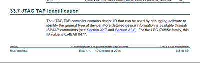

The 176x controllers are a bit older ... I only found this:

Supposedly even with the "Memory View" in the debugger:

@frank_m That is not the same thing.
@zengy I wouldn’t be surprised if the serial number is generated on the fly by code. I.e. there is not a location that contains the value. NXP do not publish their ROM code or algorithm, so I think you are stuck. A workaround would be to have a function in your code dedicated to returning the serial number. You can then use  gdb script commands to execute that code from within the debugger and display the value. Not nice, but it would work.

Not sure what the "JTAG ID CODE" right above is either.
I suppose the OP meant this ID code, which just identifies the MCU type.
6,566 Views
converse
Senior Contributor V
JTAG ID CODE is how a debugger identifies what it is talking to. Afaik it is define by ARM and will be the same for all Cortex-M3 devices (for example)
DEVICE ID 0 is defined by NXP and will be the same for all LPC1768 etc device
DEVICE ID 1 identifies the revision of the part
none of these is unique to a particular device.
@zengy is trying to get the unique device identifier (I think this is a 128 bit GUID)
