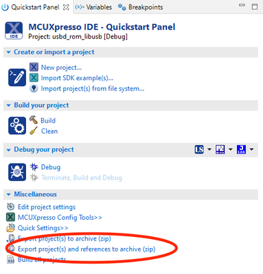

converse
Senior Contributor V
Sorry, but that does not help at all. To be able to help, I need a complete, buildable project, with all dependencies... You can create such a package from the Quickstart panel:

jmueckl
Sorry about that.  I have attached the project as you have indicated.
