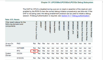

thanks for the help. I see from the table that POR  acts on RTC as nRESET so what you said also applies to me...

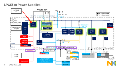

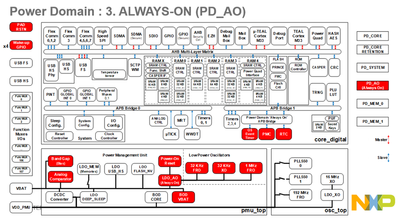

VBAT_PMU is relevant to the RTC supply. Technically we can just provide supply to VBAT_PMU to keep RTC running. But we don’t expect current consumption is very low. Because VBAT_PMU uses LDO to lower the voltage, while LDO is power consuming:
Besides, VBAT_PMU is for PD_AO domain. This is not only provide power to RTC but also other modules in red as below picture.
Hope this explains the issue.

When power on LPC55, it perform POR reset. According to below table POR triggers RTC reset. That's to say, RTC counter will be initialized and cleaned.
So in order to keep RTC running and  disregard POR reset, I have two options:
1. Using exernal RTC
2. using low power mode (eg, power down mode) to replace powerdown MCU, waking up power down mode doesn't reset RTC.
