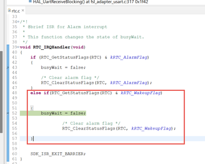

We're using RTC with 2 timers
1 Khz to wakeup from low power modes
1 hz for alarm events
So what we noticed is sometimes alarm doesn't fire!
digging down we found that when we reset Wakeup Rtc timer "Turn it off then oN" it clears Alarm flag if it's set while it shouldn't as per datasheet 1 khz timer shouldn't affect 1hz timer
Can you please verify as it's causing a big issue to us and advice how to solve!

I ran your code on an LPCxpresso54114 board, but it didn’t work well. Maybe you used your own board. Therefore, I modified the RTC demo under the SDK according to your requirements. The original RTC demo focused on alarms, so I added a wake-up interrupt. During debugging, both the alarm and wake-up interrupt triggered successfully.
Due to our company policy, we cannot send code to customers, so I have taken a screenshot of the added code. I highly recommend that you first evaluate based on the SDK RTC demo.

/*Main function*/
main(void)
 read rtc time();
set RTC alarm after 1 second();
set wakeup interrupt after 2 seconds();
while(1)
/*Handler*/
RTC_Handler()
 status = read rtc status();
if(alarm)
 print("OK");
else if(wakeup)
 print("Done);
RTC_EnableWakeupTimer(RTC, false);
RTC_EnableWakeupTimer(RTC, true);
You'll see logs till wakeup interrupt is generated.
As you can see i am not clearing any flag just to make sure interrupt is always pending

Hello @AD11
From the pesudo code, there is no logic issue.
Please check whether you cleared the flag by mistake.
I still recommend that you share a simple project code that can reproduce the issue.

Please find attached an example
Alarm after 1 second
Wakeup interrupt after
Logs will keep printing till wakeup interrupt is fired and wakeup timer is reset then both Alarm and wakeup flags will be cleared which should only be wakeup flag
