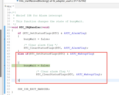

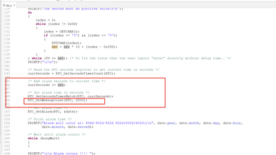

I ran your code on an LPCxpresso54114 board, but it didn’t work well. Maybe you used your own board. Therefore, I modified the RTC demo under the SDK according to your requirements. The original RTC demo focused on alarms, so I added a wake-up interrupt. During debugging, both the alarm and wake-up interrupt triggered successfully.
Due to our company policy, we cannot send code to customers, so I have taken a screenshot of the added code. I highly recommend that you first evaluate based on the SDK RTC demo.
