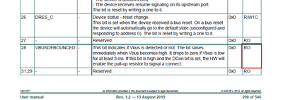

I noticed in UM11071 that when both DCON (bit 16) and VBUSDEBOUNCED (bit 28) in DEVCMDSTAT are 1, the devices status changes to 'connected'. So, the code should include a condition that checks these two bits to ensure USB Initial or Run succeeds, leading to normal enumeration, right? Can you tell me the key word to focus on?

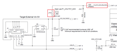

On the LPC51U68 EVK, JP10 connects the USB VBUS signal to P1_6, which is the dedicated USB0_VBUS pin. When JP10 is shorted, the MCU can detect VBUS, set the VBUSDEBOUNCED bit, and proceed with USB enumeration.
If JP10 is open, the MCU cannot detect VBUS, meaning the VBUSDEBOUNCED bit never gets set. Consequently, the internal pull-up on D+ will never be activated, causing enumeration failure.
If you want to bypass the VBUS detection mechanism by simulating it in software. Since you’ve already tried configuring P1_6 as GPIO, you could manually set the VBUSDEBOUNCED bit using the DEVCMDSTAT register.
However, the VBUSDEBOUNCED bit is read-only, meaning it’s not directly writable by software.

To verify whether the Connect function works, I performed open-circuit and short-circuit tests on JP10 of the LPC51U68 EVK. When JP10 is shorted, enumeration works normally, but when it’s open, enumeration fails.
Regardless of whether I configure P1_6 as USB0_VBUS or GPIO, after opening JP10 and monitoring D+ with a Logic Analyzer, I found that during operation, there’s no period where D+ goes high, meaning enumeration fails.

Additionally, the description in Section 22.4.3 seems inconsistent with the description of the DCON bit in Table 348 of the DEVCMDSTAT register. The DCON bit is described as:
'The connect bit must be set by SW to indicate that the device must signal a connect. The pull-up resistor on USB0_DP will be enabled when this bit is set and the VBUSDEBOUNCED bit is one.'
It appears that the VBUSDEBOUNCED bit must also be set to 1, and since VBUSDEBOUNCED is tied to the VBus detection pin. Does this mean VBus detection is required for D+ to be pulled up?
I’d like to ask: If I don’t connect JP10, what methods can I use in the LPC51U68 example code to ensure normal USB operation? Or is it absolutely necessary to short JP10 for VBus detection to enable USB to perform subsequent actions properly?

Thank you for your response. Your method is feasible. However, I later noticed a pull-down resistor R75 near P1_6. Therefore, I performed an inverted operation on P1_6 and left JP10 open circuit, allowing the LPC51U68 to interpret 0 as 1.
