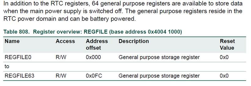

We got a 8D quality urgent case, which we found caused by RTC general purpose registers on LPC1857.
It seems the data stored in REGFILE59 changed randomly in some condition.
For most boards, there had no problem, except 4PCS we found currently.
The MCU on the problem boards have 2 PCS with ESD15330A and ESD15370A separately.
We're struggling to find the root cause.
It's appreciated that someone could give us some hints for this problem.

First of all, thank you for the patience.
I got the feedback from LPC product team:
The LPC1857 User Manual with incorrect description about RTC general purpose registers reset value.
The correct description is that: The register value is undefined after reset.
It's a document issue. Thank you for the attention.
Wish it helps.
