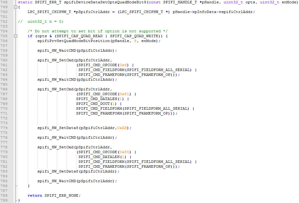

I was previously using lpclibspifi version 1.03 and I found the more recent version 1.14 bundled with MCUXpresso.
I have been looking through the differences and had a question about the function spifiDeviceDataSetOptsQuadModeBit9 which enables quad SPI mode.
The previous version of the function simply set the "quad enable" bit in the status registers, very straightforward.  However the new version of the function performs additional operations and I'm not sure what it's trying to accomplish.  See lines 760-785 of this image for the code in question.  I also attached the code to this post if that's easier.
I'd like to understand the new behavior to see if it's something I should incorporate, or if I should avoid the changes in an effort to reduce risk.  Thanks for any insight.

Thank you for taking the time to respond.  You are correct, I am looking at the examples that come with MCUXpresso.
That's what I found as well, that the spifiDeviceDataSetOptsQuadModeBit9 function exists for Micron parts, and the spifiDeviceDataSetOptsQuadModeBit9Simple exists for other parts.
However, I still see issues with the library.
First, the conditional compilation flags that are used to include/exclude parts from the build process are incorrect.  As I've copied here, you can see that the wrong parts are included with the wrong flags.  This is very misleading and should be corrected.

#define NEED_spifiDeviceDataSetOptsQuadModeBit9Simple (SPIFI_DEVICE_ALL |    SPIFI_DEVICE_GD25Q32C)
Second, almost all of the flash parts are defined and configured to use the wrong spifiDeviceDataSetOptsQuadModeBit9.  They should be using the "simple" version, but they are using the Micron version.  This is a mistake that needs to be corrected.
Third, there are other conditional complication flags that are simply missing.  For example, SPIFI_DEVICE_GD25Q32C is not actually defined anywhere.
My suggestion is to completely remove all of these conditional compilation flags (SPIFI_DEVICE_*, NEED_*).  They make the code difficult to read, they are out of date, and they are a maintenance nightmare.  If someone then wants to remove support for unneeded parts, they can simply delete them and be done with it.
I've done exactly this within my own code base, and it's so much easier to read.  I've also formatted the code to get consistent formatting (no tabs, consistent indentation, etc) and it looks much more professional now.
Anyways, just my two cents.  I hope these issues get corrected in the SPIFI library.  And I hope this is helpful to anyone which might read it.

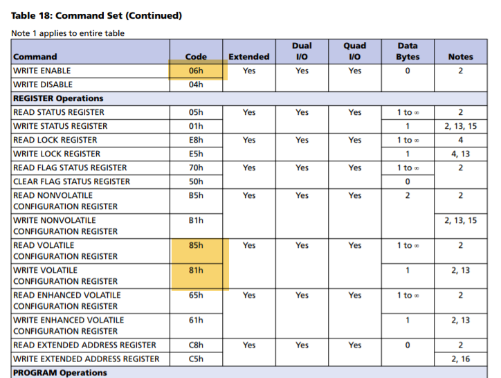

Are you using the LPCOpen examples that come with MCUXpresso?
The usage of the spifiDeviceDataSetOptsQuadModeBit9 function or the spifiDeviceDataSetOptsQuadModeBit9Simple will depend on the device that you are using, you have to make sure the Flash memory being used supports the option. For example, the spifiDeviceDataSetOptsQuadModeBit9 function can be used with the Micron Flash:
If you can't find references to these commands on the manual of the memory that you are using is better continue using the spifiDeviceDataSetOptsQuadModeBit9Simple function.
Hope it helps!
