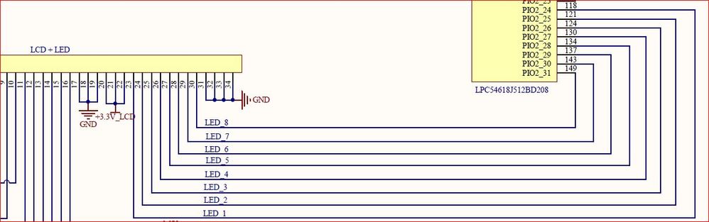

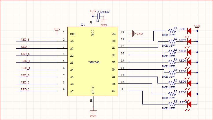

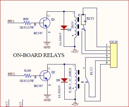

gmk1
1st image Relay connection where PFC1 & PFC2 are controller GPIOs.
3rd image shows Led connections with controller GPIOs
2nd image shows Led Nets are extended to other board
