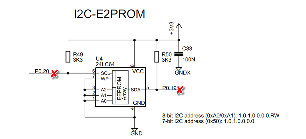

Hello Bernd Sirozynski,
I know you config the pins to GPIO function, while on the demo board, the two pins have already connected
to other chip. please cut the P0.19 and P0.20 to have a try:

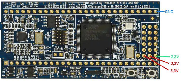

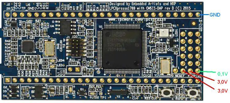

to simplyfy the test i uses 3 Pins of the Board, because they are direkt side by side on the LPCXpresso board:
these pins are:
P0.20  // at this pin there is a problem
P0.19  // at this pin there is a problem
P4.29  // no problem, only to compare the behavier
if you measure the voltage level you see, that
P0.19 = near VCC 3,3V
P0.20 = near VCC 3,3V
P4.29 = ca. 2,3V  (internal pullup is a current source)
now i enable the pulldowns of the P4.29 and for P0.19 and P0.20:
and see the following voltages:
P0.19 = 3,0V      // that is not correct
P0.20 = 3,0V      // that is not correct
P4.29 = 0,1 Volt  // okay

next i set the portmode to "Pin has neither pull-up nor pull-down resistor enabled" value 0x02
the pins goes high and have problems to pull it low with external resistor.
with external 10 K pulldown the level is 2,465V
with external 1K pulldown the level is 0,760V
Info: All measures are done with a high impedance >10 GOhm Multimeter DM3068 Rigol

berndsirozynski
Hello Alice_Yang,
you're absolutely right, I didn't see that.
Thank you very much for your information,
I spent hours looking for the problem,
I've been working with these parts for years and I didn't even notice.
I am getting old (I am old) :-)
Bernd
Please check whether the two pins connected to other parts on your board, for example I2C-EEPROM.
Or you can send the schematic to me, I help you to review. For this is a old version(2010), I only have the new one(2016).
