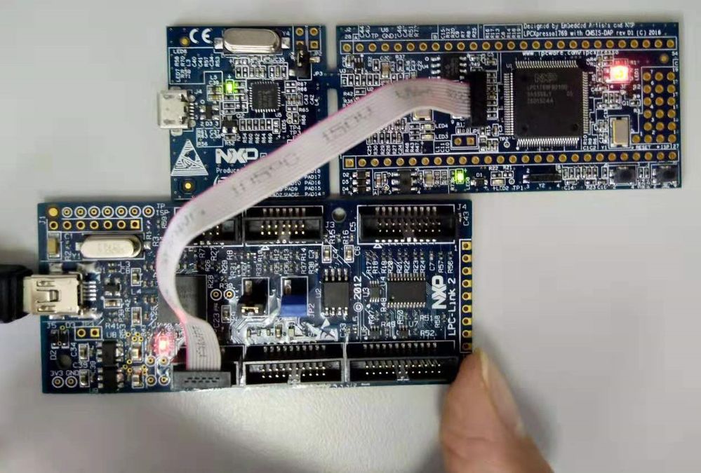

I'm planning to develop a certain demo board with LPC1769. The concept is that LPC-LINK2 can be used for debug.
In order to check how LPC1769 works, I bought LPCxpresso CD 1769 OM13085 and try to connect to LPC-LINK2. However MCUxpresso said "Could not connect to target". Below is my procedure. If I have something to make correct, could you advise me?
1. LPC-LINK2' JP1 and JP2 is closed after J-LINK firmware was written.
2. Connect between LPC-LINK2 JP7 and LPCxpresso CD 1769 J1
3. LPCxpresso CD 1769's JP3 is open
4. Press blue beetle button after open periph_blinky in LPCOpen.
5. Said "Could not connect to target"
Please also refer to an attache file.
Besides that, after I connect LPCxpresso CD 1769' USB to PC, I pressed blue beetle. MCUxpresso could not find any debuggers.
If you have any questions, please let me know.
FUKUDA

Hi Daisuke Fukuda,
for the opportunity to serve you.
Please assure the JP3 is closed if you want to use the external debugger tool.

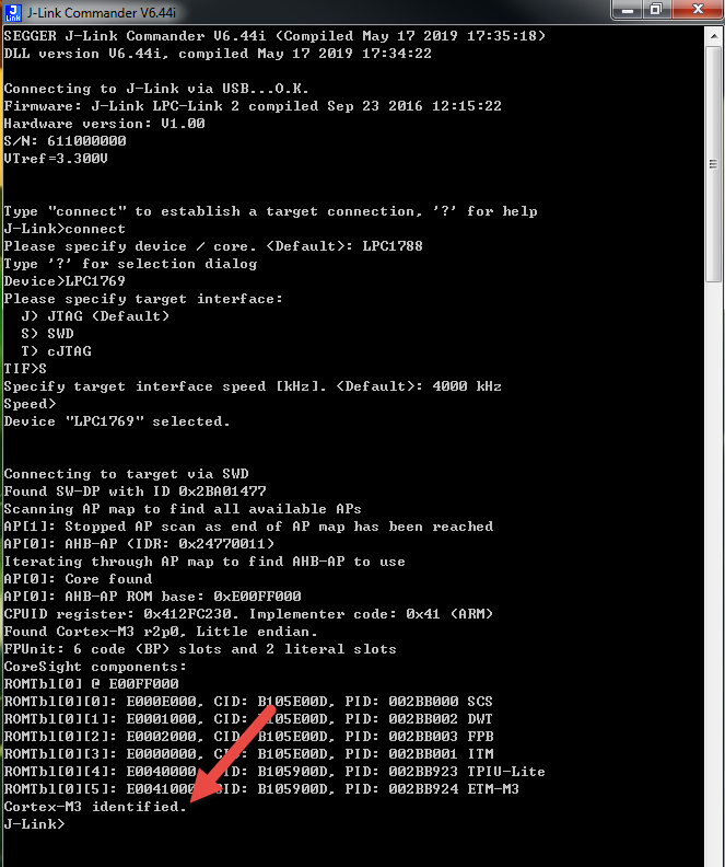

I've connected the LPC-Link2 to the LPC1769 board like the Fig1 shows, and according to the Fig2, we can see the LPC-link2 detect the LPC1769's core which means the debugger connect is correct.
Fig 1

This is Daisuke FUKUDA with NEXTY Electronics Japan. Thank you for your prompt reply and sorry for being late.
The problem still isn't resolved. I found J-link commander could identify cotex-M3. However MCUxpresso wasn't able to work correctly. For detail, please find an attached file.
Do I have anything to make correct?
FUKUDA
