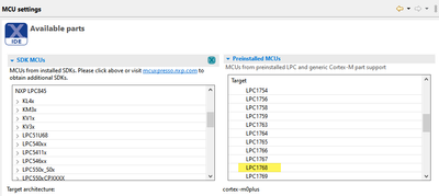

I was told to use a LPC-Link2, which is obsolete, to program the LPC1768 device. I see MCU-Link Pro Debug probe and MCU-Link Debug Probe listed as replacements to the OBS LPC-Link2, but it doesn't list LPC1768. What can I use.

The new MCU-Link and Pro probes do support the targets of the LPC-Link2, including the LP1768
I hope this helps,
Erich
