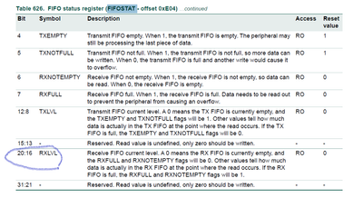

As you know that USART module has only one interrupt vector, mutiple interrupt trigger sources share the same interrupt vector. So in the ISR, you have to poll the trigger source and take action.
For the receiver of USART, it uses FIFO to receive data, so in the ISR, you can check how many bytes have been received, then read them.

receiveByteNumber=(USART2->FIFOSTAT>>16)&0x1F;

For the usart status register, pls refer to the table in UM11295.pdf

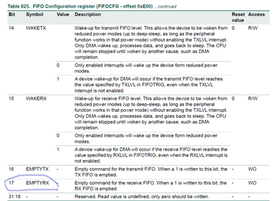

I think when you read the receiver, you have to check the FIFO status register and guarantee there is data in the receiver FIFO.
If you want to empty the receiver FIFO, you can set the EmptyRX bit in the configuration register.

You can set the EMPTYRX bit with the code:
If you use USART0, you can use the code:
USART0->FIFOCFG|=USART_FIFOCFG_EMPTYRX(1);
or
USART0->FIFOCFG|=1<<17;
If you use USART1, you can use the code:
USART1->FIFOCFG|=USART_FIFOCFG_EMPTYRX(1);
or
USART1->FIFOCFG|=1<<17;
