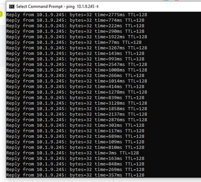

Dear every One.
I have project use LPC4078FBD80, use Keil-C IDE and TCPnet Library. use LAN8720A Phy and RMII interface.
all work well such as: httpserver, TCP, UDP, NTP..  and after soon reset, Ping time live is < 1ms, it is OK
but after this (about 6-10h) Ping time live increase (as below picture). and can't download file.bin from Fpt server. (ratio success is 1%).
Have any one meet this issue pls let me refer solution???
Many thanks.

The information you provided is limit.
Is your project based on LPCopen domo code ?
How to reproduce this issue?

thieuqp
Dear @ZhangJennie . Thank for your reply.
I've porting code from periph_ethernet/enet.c to my project, and all feature is OK: TCP, http server, NTP..., and after reset, Ping time live < 1ms, only connect to ftp server, ping time live increase.
because i'm use thirdparty TCPnet library, then NXP have no examples similar.
pls let me if you have example for ftpserver.
