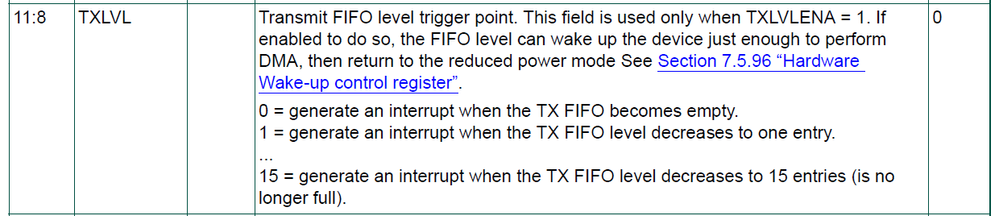

Hi SST Informatique,
After initializing the UART, the TX FIFO is empty, meanwhile, the transmit FIFO level trigger is 0, I think it can explain repeat enter the transmit FIFO level interrupt.

sst1
Good try, but this is not the case :
- Theory : FIFO is empty and the irq should be triggered when it **become** empty
- Real world : I already tried to set the TXLVL to 1 before enabling the irq, and the result is the same.
Any other idea ?

jeremyzhou
Sorry for the late reply.
There're suggestions for you for further testing
1. Increase TXLVAL(>1).
2. Clear the TXLVL interrupt status in the interrupt function.
Please give a try.
